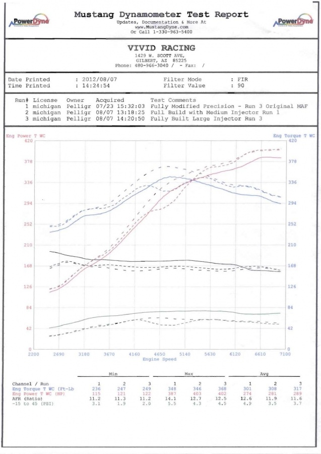

Originally Posted by white out
Power with the C2 trans (G96), not the engine.
470chp or 470whp?
what is your peak torque?
I have a 99 C4 AWD.
On a Mustang Dyno she put 402hp and 368tq to all 4 wheels. The 996 has a 17% loss in drivetrain, that puts it at 470hp and 430 ft/tq at the crank @4.5psi of low boost.
