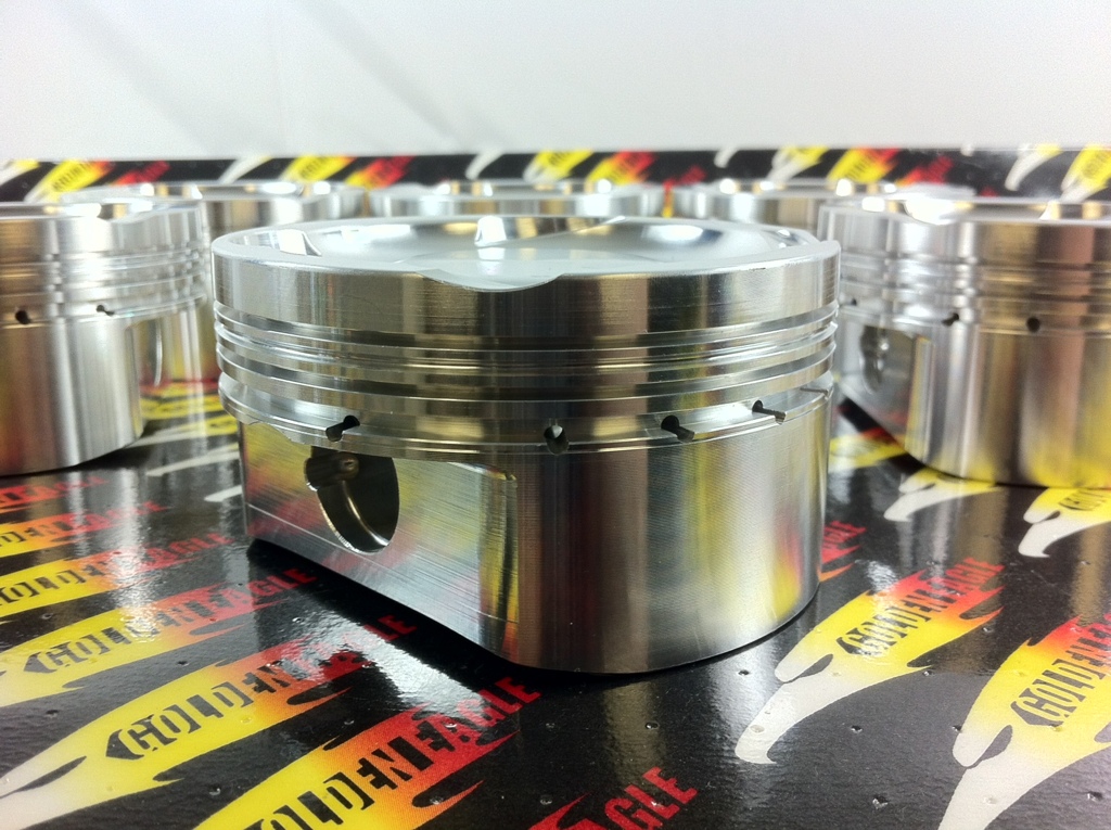

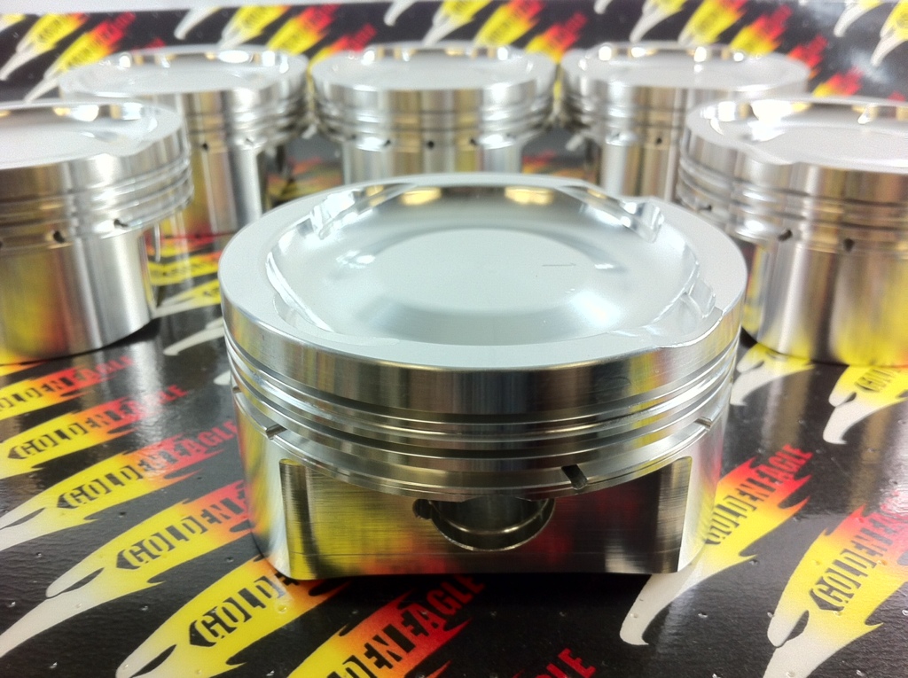

It's been a while since Ive updated this post but we had a few "hickups". Kind of my own fault but im glad it all worked out. We had to redesign some pistons but all the guess work was taken out when we sent in a set of heads to measure out the volume of cc in the heads and head gaskets and get the valve clearances so that the pistons work be exact on the C/R.
In a way it would of been a heck of alot easier to just stick with a 3.4l 96mm piston because we could just scan that piston use the current stock c/r #'s to figure out the correct dish to get 9.0:1 but thats all behind me now.

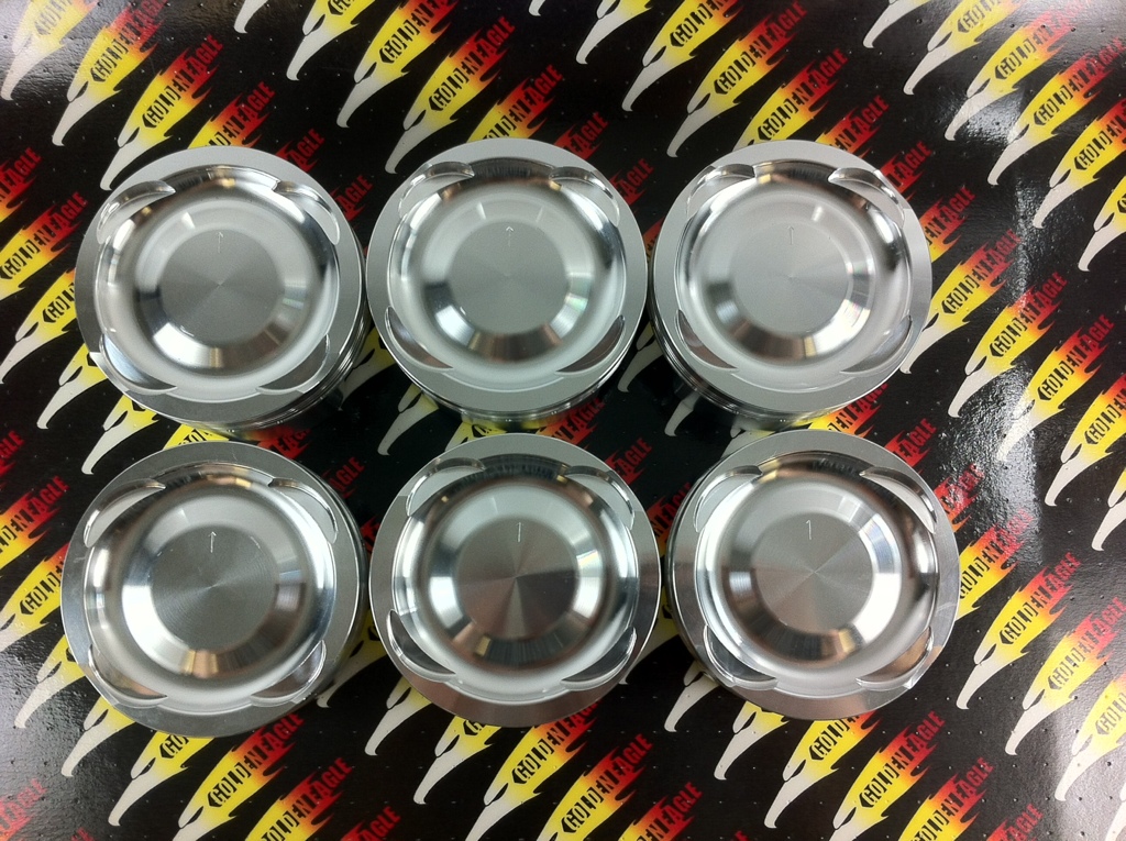

Arias pistons are now done!!! but they still got to go out for ceramic coated tops and moly coated skirts. Here are some pics of the completed pistons.

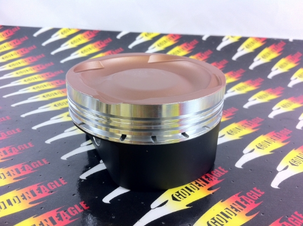

not huge progress but the piston coating is all done.

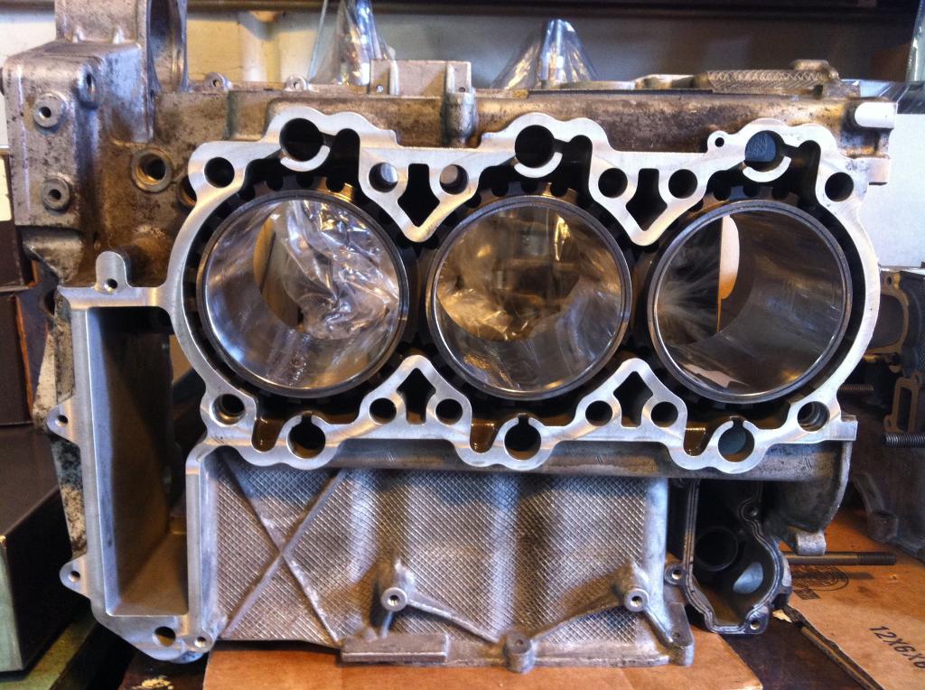

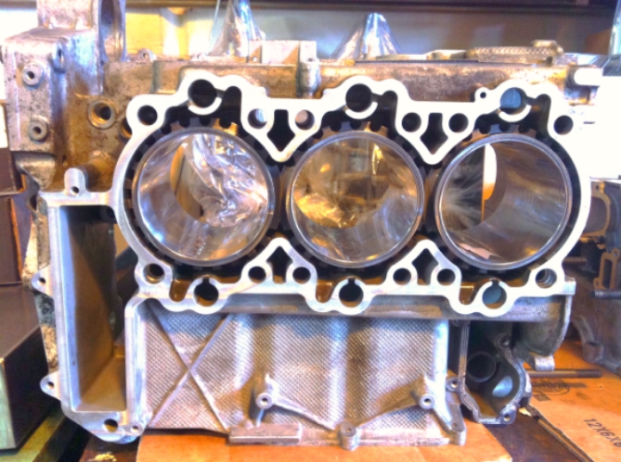

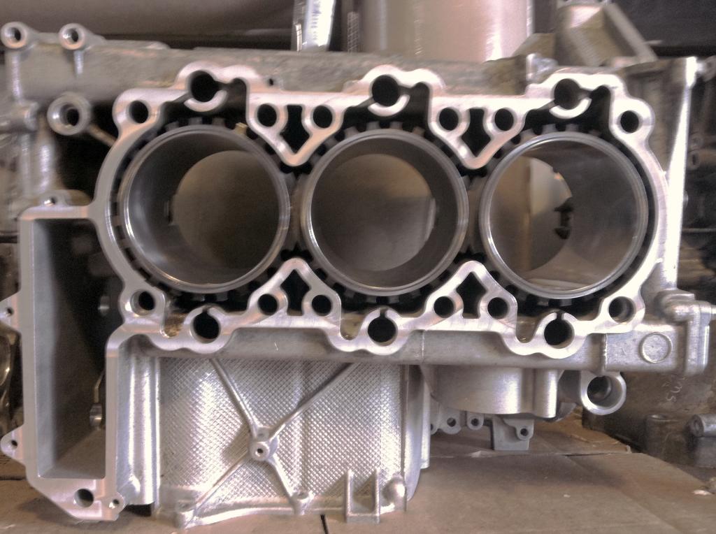

Well it been about 3 months since I've updated my poor lil build. To be honest not much has realy changed but I did realize that I never posted pictures of my block with sleeves installed and grooved for o-rings. I am down to needing to port my heads, build a set of 4-cams, and coating a set of main bearings to get this block complete to put back in the car.

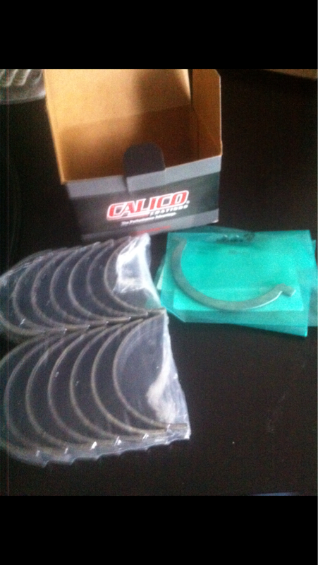

Got my coated bearings back! : ) Click image for larger version
