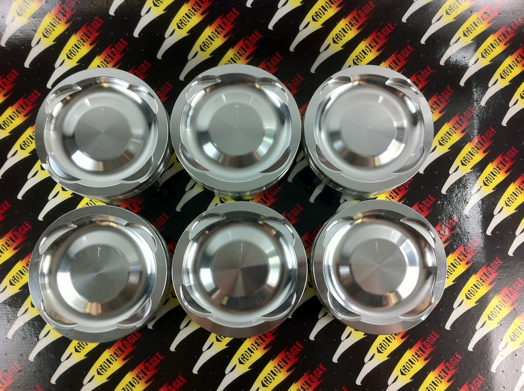

Are you using 99mm 997 3.8 pistons as well? or custom?
Thanks for the info! 3.8l 2000 C2 should be fun. Right now I have a boxster S motor in my 996 (3.2l)
Old Apr 17, 2014 | 10:09 AM
  #65
BiteEmNBeatEm's Avatar
Joined: Jun 2010
Posts: 544
From: SA, TX
Rep Power: 49
BiteEmNBeatEm has much to be proud ofBiteEmNBeatEm has much to be proud ofBiteEmNBeatEm has much to be proud ofBiteEmNBeatEm has much to be proud ofBiteEmNBeatEm has much to be proud ofBiteEmNBeatEm has much to be proud ofBiteEmNBeatEm has much to be proud ofBiteEmNBeatEm has much to be proud ofBiteEmNBeatEm has much to be proud of

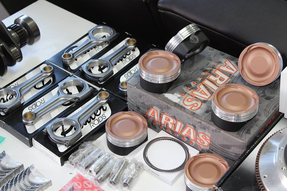

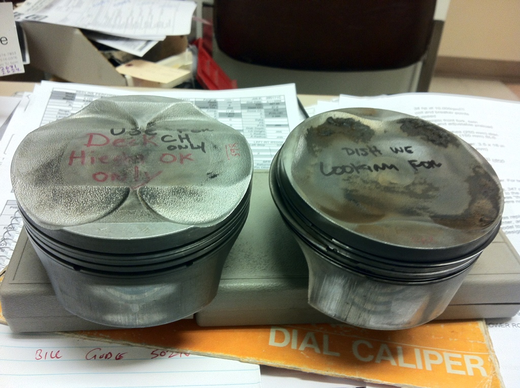

Amille28 the pistons are a 99mm bore but not from a 997 since the valve cut/size/locations are different. I had to have them scan in a 3.4 piston to use as a reference for the valve cuts and then increase the piston size from 96mm to 99mm. Then we had to measure the cc's in the head to get the right compression ratio that we wanted in the pistons based off the factory head gasket thickness.
here is a 3.6 on left next to a 3.4 on the right. both pistons were from the shops pile of parts...lol
then this was the outcome : )

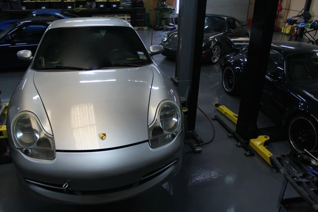

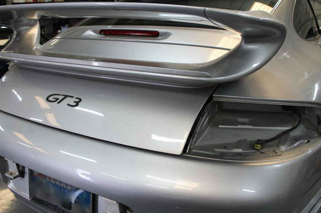

Not a whole lot in the sense of updates but hopefully here in the week or two I'll be able to post some engine build photos as it gets put back together.

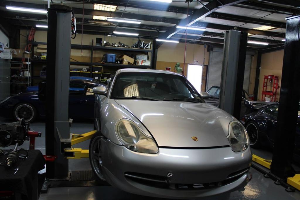

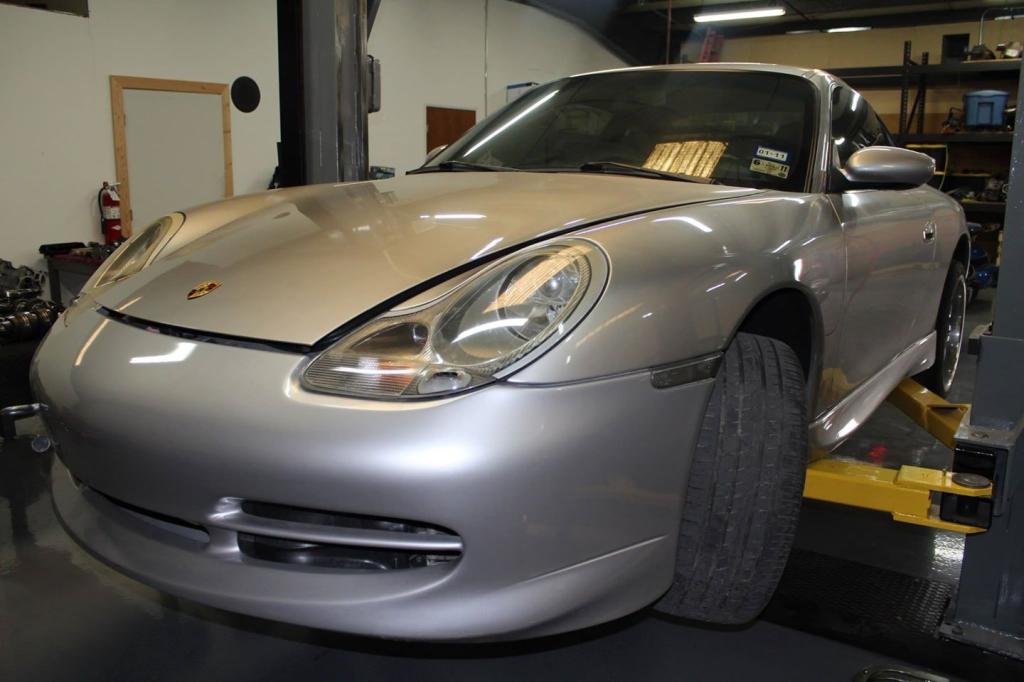

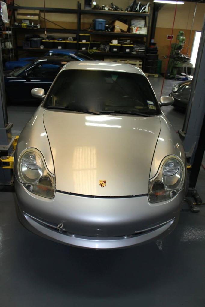

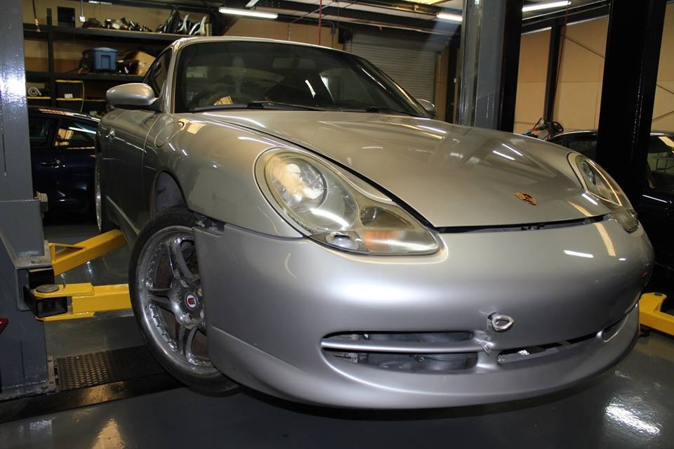

Here are some pictures of my 996 MK1 Aero (gt3 poser lol) as it sits on the lift at 9XX Motors.
ID:	379485   Click image for larger version
ID:	379486   Click image for larger version
ID:	379487   Click image for larger version
ID:	379488   Click image for larger version

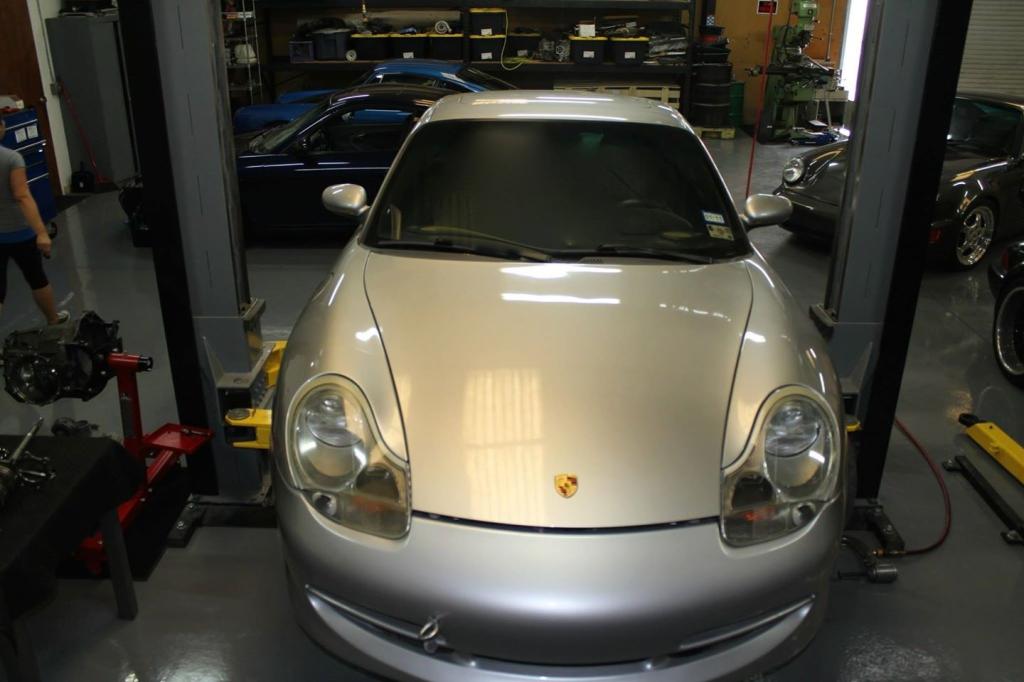

and a few more...
My favorite photo being the "Porsche Crest"
ID:	379491   Click image for larger version
ID:	379492   Click image for larger version
ID:	379493   Click image for larger version
ID:	379494   Click image for larger version

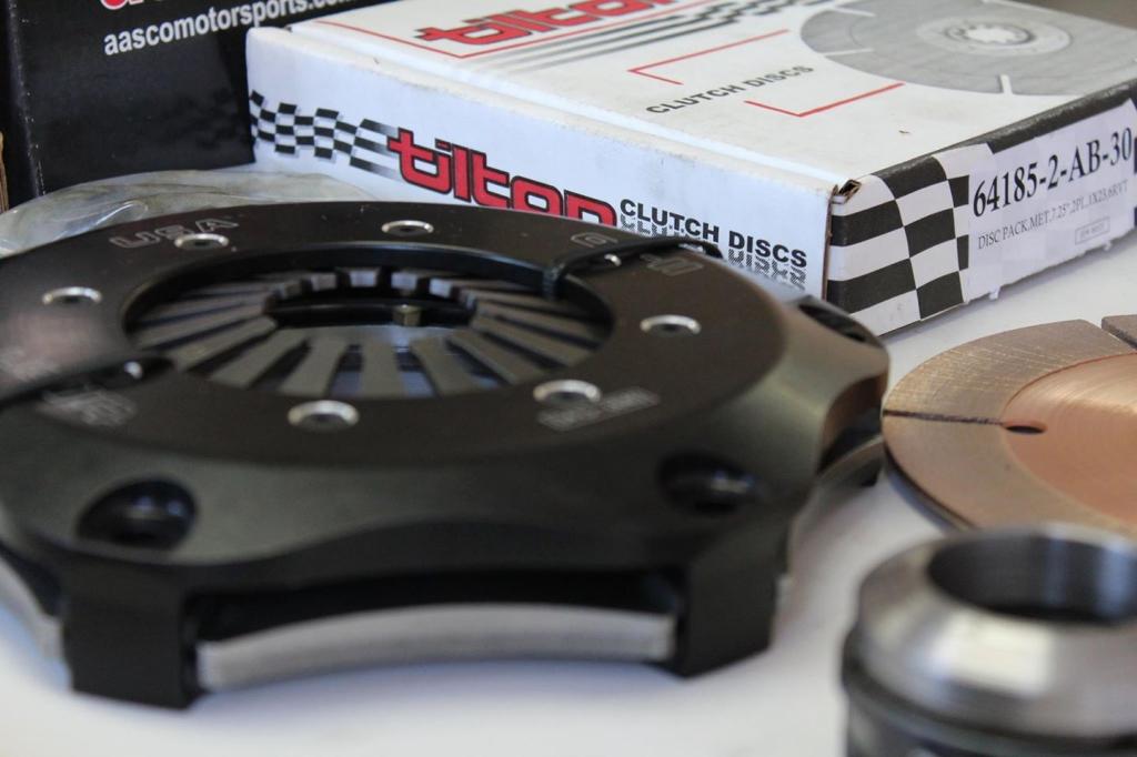

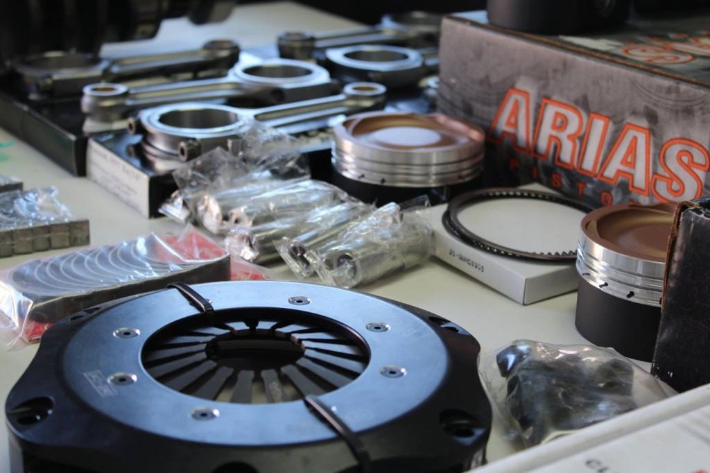

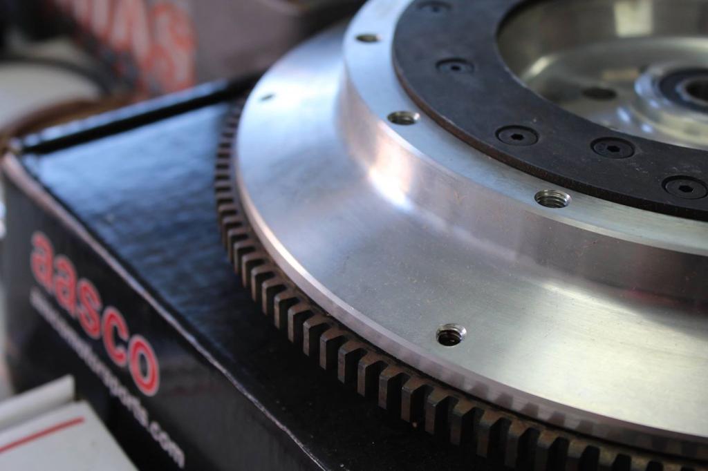

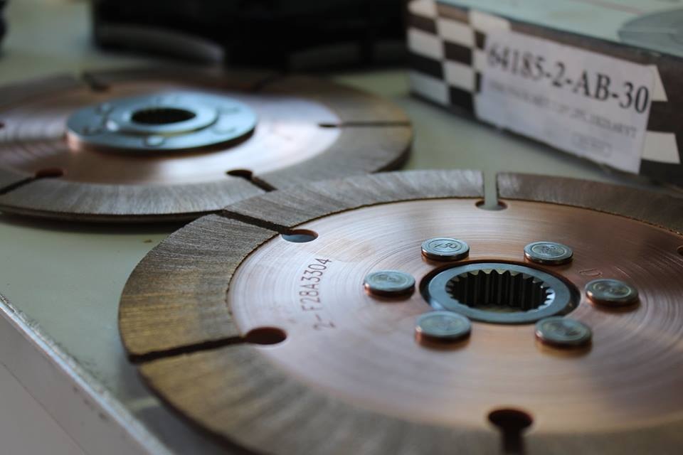

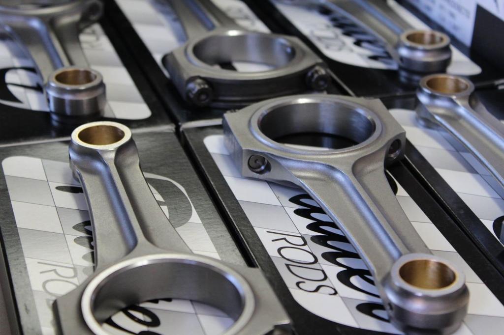

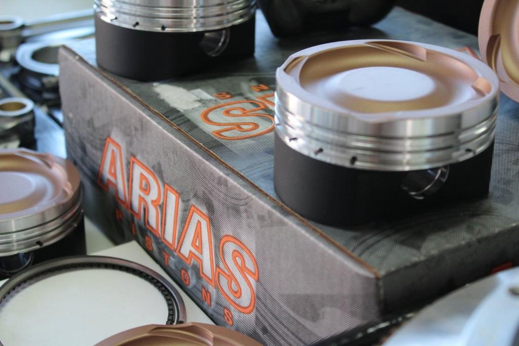

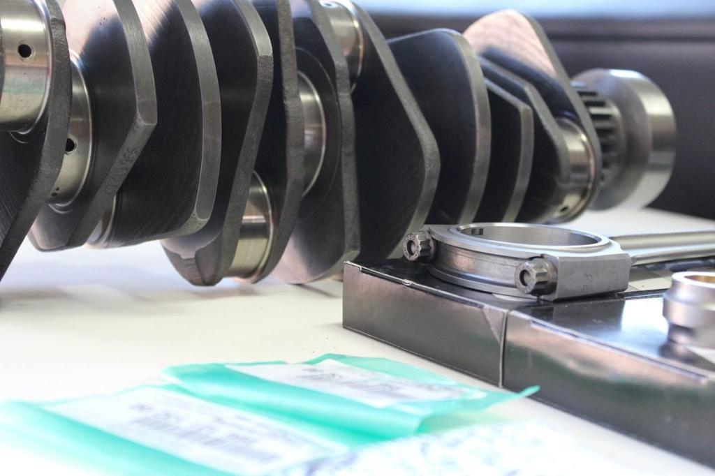

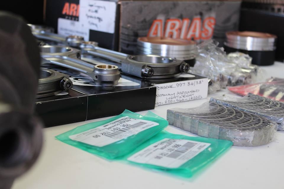

Here are some new pics of the internals for the build...
ID:	383095   Click image for larger version
ID:	383096   Click image for larger version
ID:	383097   Click image for larger version
Old Jun 5, 2014 | 05:23 PM
  #74
Joined: Jun 2010
Posts: 544
From: SA, TX
Rep Power: 49
ID:	383099   Click image for larger version
ID:	383100   Click image for larger version
ID:	383101   Click image for larger version
Old Jun 5, 2014 | 05:28 PM
  #75
Joined: Jun 2010
Posts: 544
From: SA, TX
Rep Power: 49
ID:	383103   Click image for larger version
