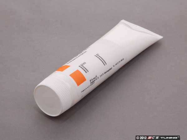

I need to change the spark plug tubes on the driver side. In the parts forum it says I must use this special grease on the tubes. Do I have to rub this grease on the inside or outside? Or is it just for the rings at the ends?

The grease just goes on the o-rings at the ends of the tube. Shown below is the grease that is recommended by Porsche and I would use. Click Here for more information.

The grease is really just to lubricate the o rings during installation. $30+ is a lot, I just used engine assembly lube from NAPA for about $5. Just my opinion.

Dharn55 i don't know about that what if that grease can not handle the engine heat? It could dry off the rubber o rings and crack then i have to do this again in 1000 miles. For $45 i do not want to chance it. But im going to look into that, you are right what makes it so special? It is just grease.

I bought my 2000 c2 about 2 months ago, as soon as i bought i did the spark plugs and Orings, the grease is just to lubricate the rings a bit so they wont deform when putting them in, i used a bit of high temp grease, all good!
