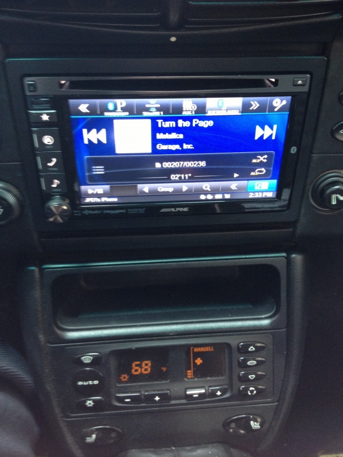

I put a double din Alpine in not too long ago and have been very happy with it!
Very nice! Thanks for sharing the picture.
