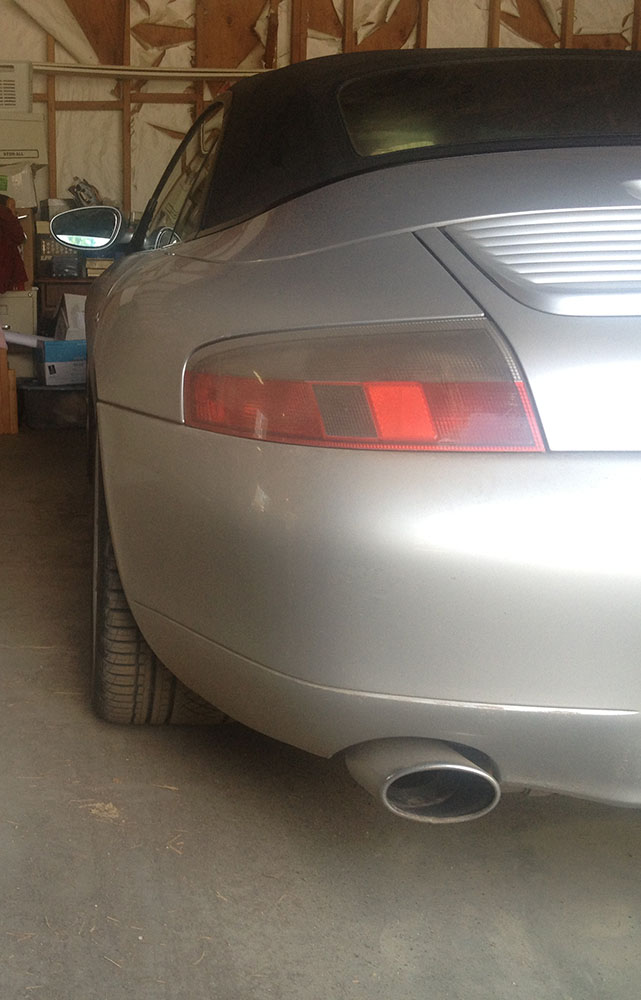

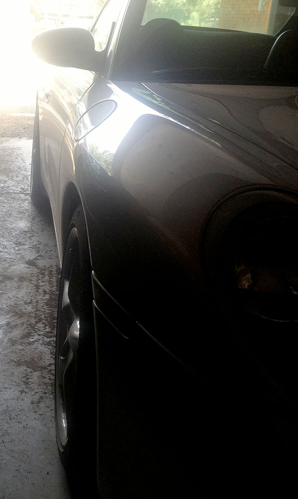

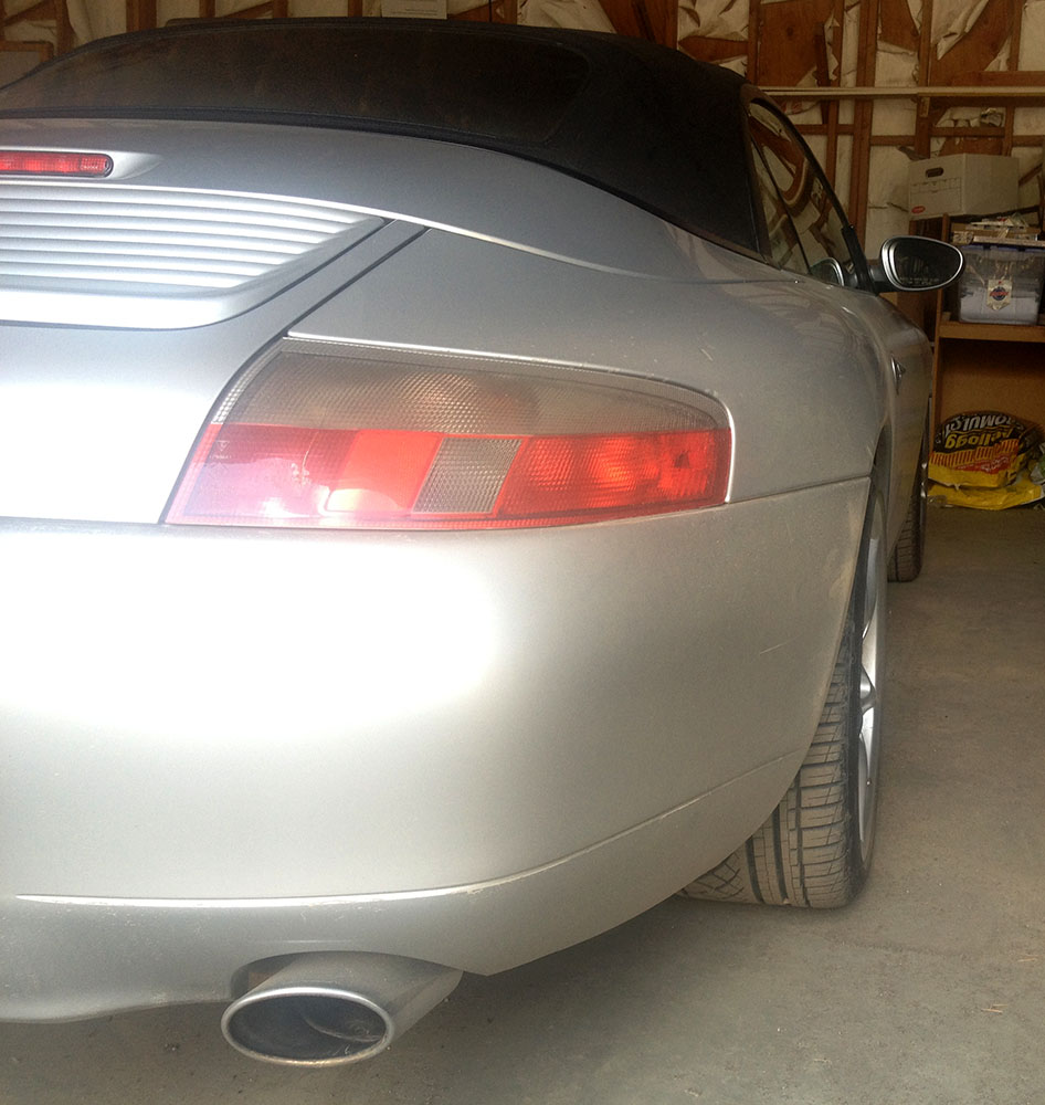

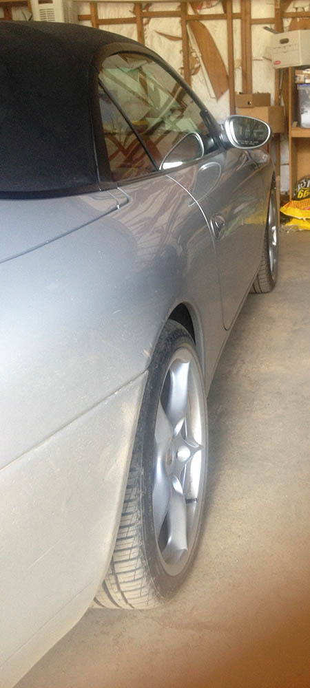

Old Apr 11, 2013 | 02:43 PM
tarzancoe's Avatar
Joined: Dec 2008
Posts: 869
From: Orange County
Rep Power: 52
tarzancoe is infamous around these parts
VERY lame pics rushed before leaving. Will post better ones but at least it gives you an idea.
Hey Tarzan the stance looks significantly better. Are you running stock tire sizes (225 f and 285 r)? Think you could go any wider (spacers) on the rear?
Looking good my friend.
Tx. Yes oem sizes.
I guess you could add a couple of mm specially with more camber. Techart goes a bit more. But I think very quickly it starts to look funny. I tried 17 rear and 7 front, and the visual effect made the rears look outside of the fender. 14 rear and 7 front was more balanced. I did put the 14 in front just in case, and then the rears happened to look ok. That is why I am saying I am not sure which I like better, 7/14 or 14/17. Probably 14/14 or 15/15 is safe and balanced. I have been staring at them for too long. We shall see in a few days

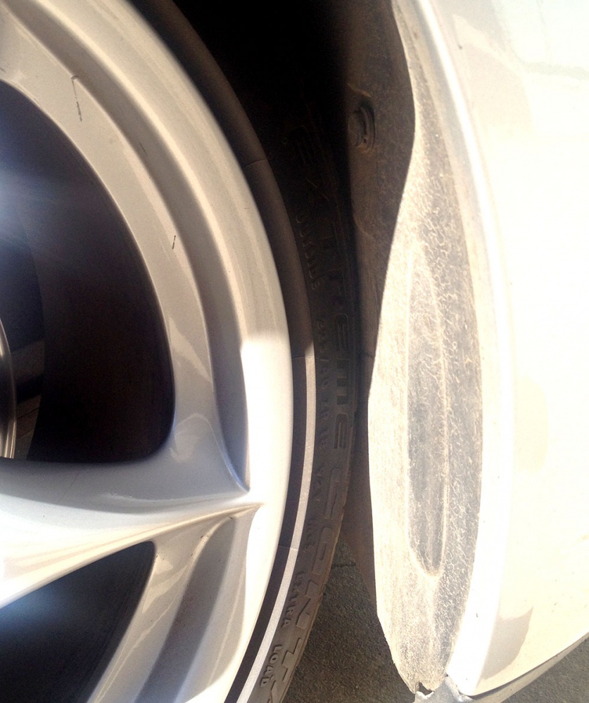

Ok, here is the deal:
Did remeasure the Techart spacers in the back: There are 15mm not 17mm as I thought. Confirmed, with techart part number on them. This is as far as you want to go, without rolling fenders, and with a conservative camber (less than 1.5 in my case).
Fronts: I did remeasure the 14mm spacers, were almost more like 13mm. Even so, they rubbed the inner liner at full lock. I did put a 7mm spacer, and they do not rub at full lock. Still, is VERY close to touching. But it does not. That's why most people do not go over 7mm.
15 and 7 it is. You can go wider in the front, and it might look cool... but why do something that is detrimental for the car's performance, maybe even dangerous? You could go into modifying the liner etc... for 7 additional mm? There is no way that 15mm will not rub at full lock. It has nothing to do with the height of the suspension, or camber.
Hope this helps. I am attaching pic of the 15mm rubbing.
