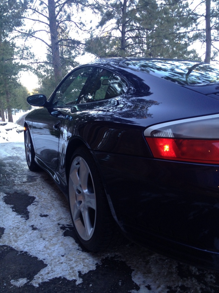

It looks fine. For the C4S, Porsche recommends a 10x18 rear wheel for winter. I'm running Sport Technos with a 48mm offset. I added 17mm OEM spacers in the rear and it looks good.
In the summer, I will go back to 11x18 rear wheels with 295 width tires and no spacers.
