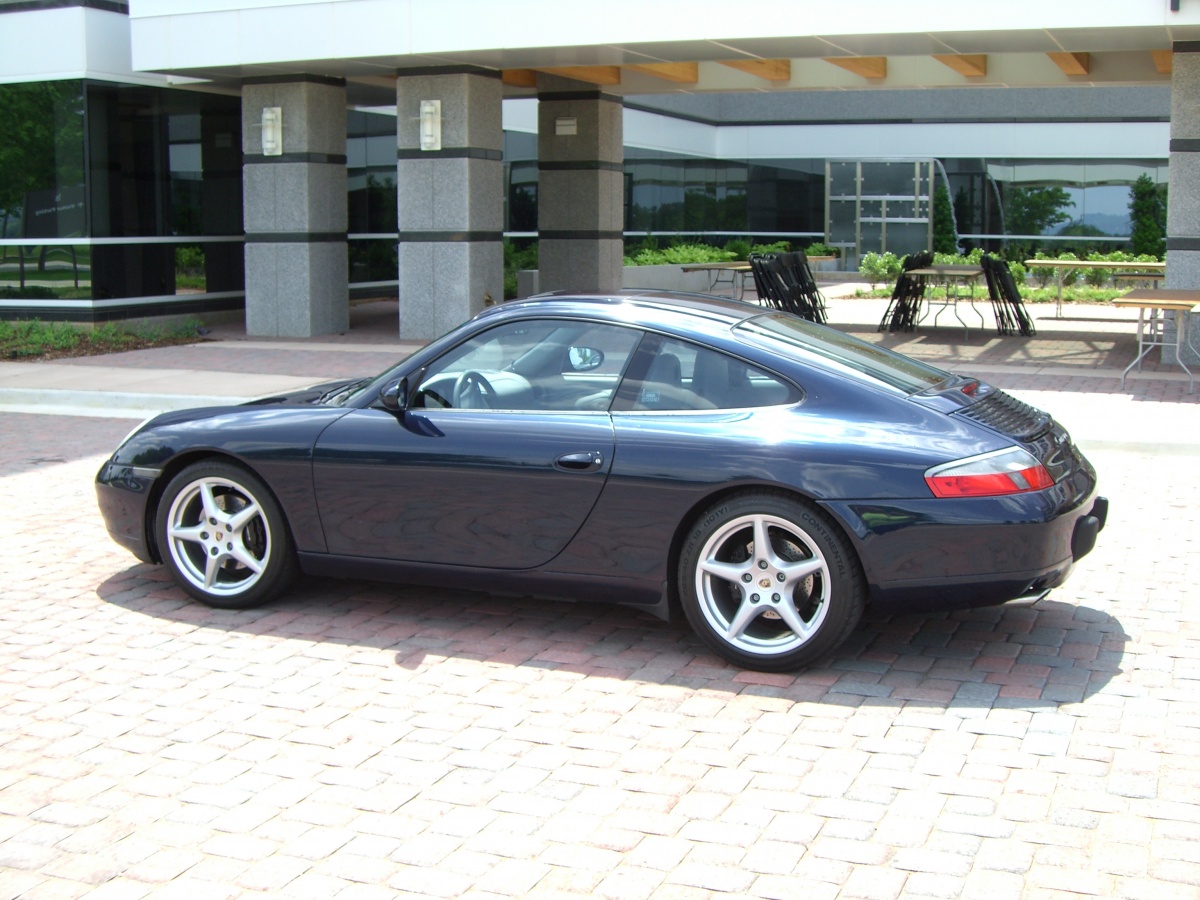

Originally Posted by Ersel
I have a narrow body 2002 with 18" and was looking to buy a 2005 18" wheel/tire combo.
Will this fit?
Here's my 2000 996 with OEM 2005 wheels and tires. No spacers, no fuss, no issues.
--Woody
--Woody
Thank you.
There are TONS of post with 996 owners running 997 wheels/tires including me. If the newbs did a simple search , they would know this and not have to ask these q's over and over again. Rant Off.
Hell FWIW, I'll be running 245 tires this summer on the fronts and 295 rears.
