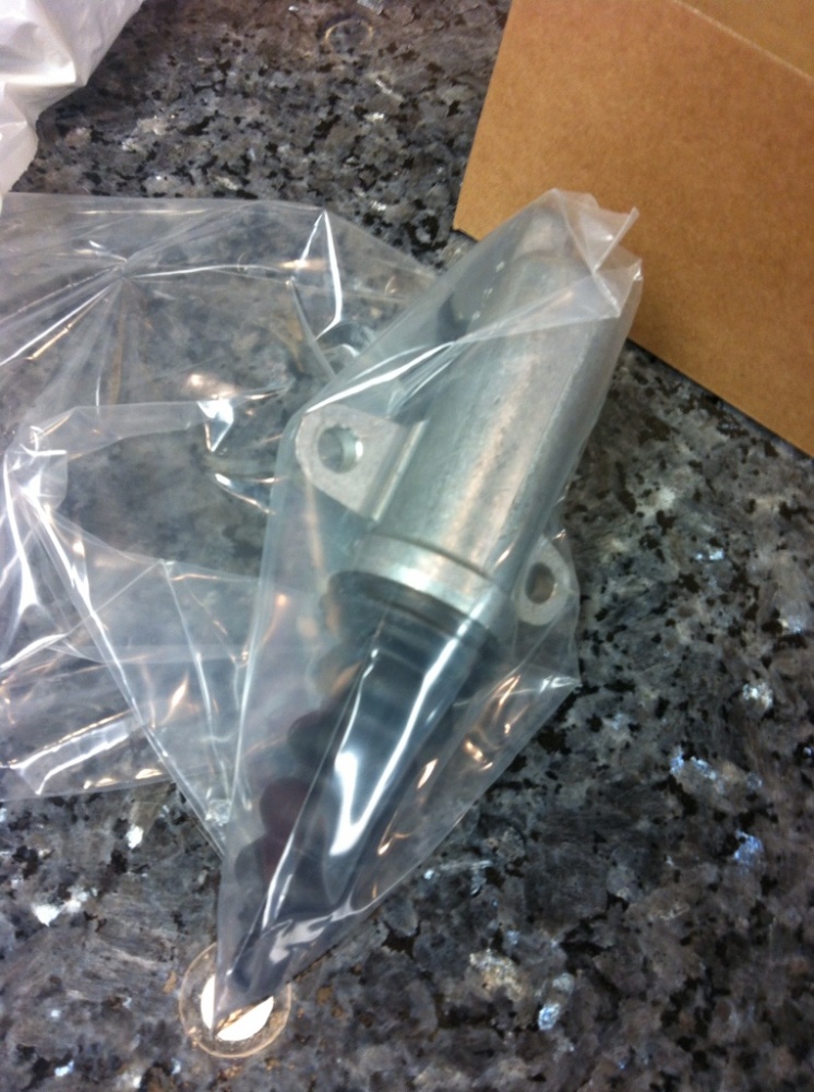

Brake/clutch fluid is easy if you have a power bleeder. Here's a write up I did about it for Lambo's:
http://lambodiy.blogspot.com/p/bleed-brakes.html
**scroll about halfway down until 'bleeding', that's the same procedure as the 911
For the clutch slave cylinder bleeding, it's on the driver side of the transmission at the very top of the transmission.
This is what you're looking for:
