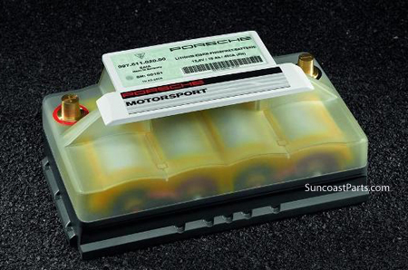

Originally Posted by judgejon
is there really such a thing as a light weight battery? go with Interstate....
There is:
However anything from PMNA is far from "bang for the buck".
This example will set you back close to $3k.
