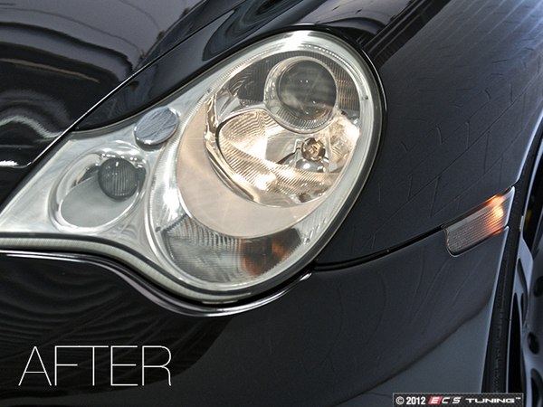

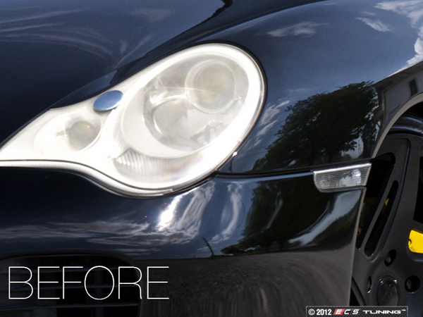

We offer a kit that includes everything you need to restore the look of your headlights. It is also advised that you protect them after you restore the look. For more information Click Here.
