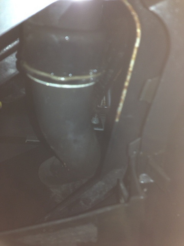

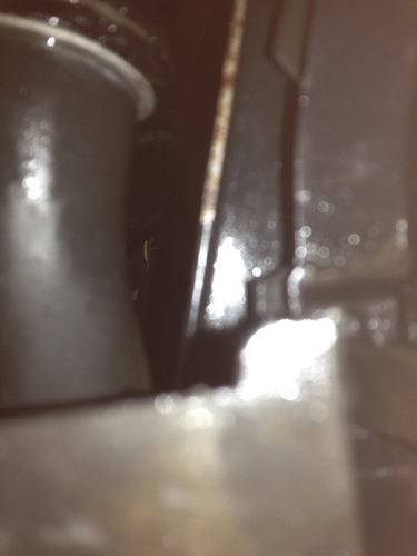

OK, I just started her and ran until it was warm. It was dry when before that, so it's only leaking when it's running. It seems to be coming from the union in the photo shown, but of course it could be running down that hose from somewhere else? I don't think I could feel any moisture further up the pipe but I'm not 100% sure. It had also gathered in the rubber underside opposite, it seems that if you rev it, it spurts out into there? I won't know until I take the bumper off this weekend but I'm 90% sure it's coming from the union in the photo. Would that indicate an o-ring failure? If so, what parts do I need?
Thanks in advance - the advice is really appreciated!

You know it could be the clamp is not holding tightly, or a small crack in the rubber hose. Looking at it you'll best know when the bumper is off, at this point though I would say it's a minor fix. I don't believe there are O rings at this location as the hose fits over the connection point.
