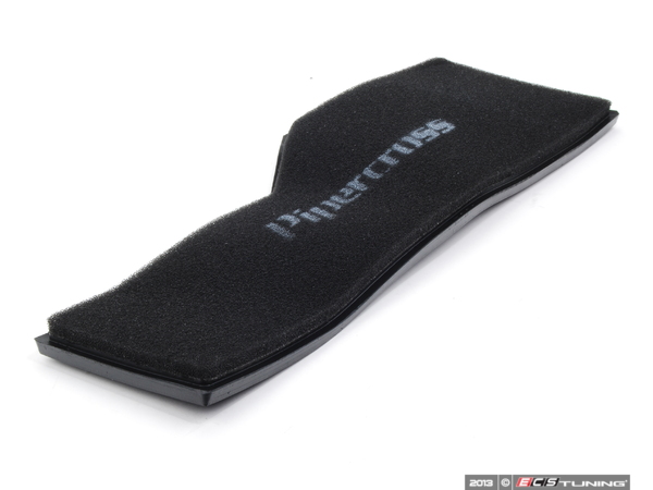

ECS Tuning - Porsche's Avatar
Joined: Mar 2012
Posts: 9,607
From: Wadsworth, OH
Along with K&N, we also carry Pipercross Air Filters that you might be interested in if you want to stick with the stock filter. Airborn dirt particles quickly clog conventional paper or cotton-gauze style filters, resulting in a pressure drop that robs the engine of air flow and power. Thanks to deep foam construction, Pipercross filters offer a drastically higher dirt-carrying capacity, allowing air to flow at high rates even after many miles of use - a claim that conventional filters cannot make.

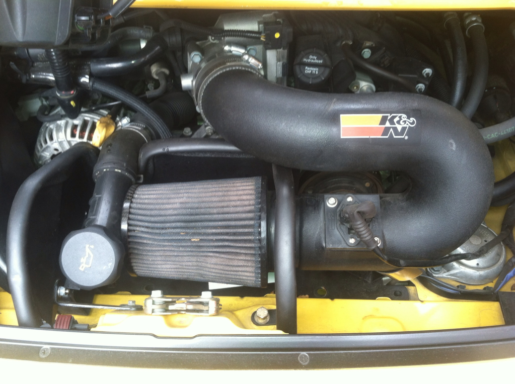

Sorry fellows shoulda mention it's one of these.

K&N Intake on my C2S triggered visit Workshop CEL
I put a Decklid with Hydraulic Wing from a Turbo onto my wife's 2005 997.1 C2S and needed to change from the stock airbox to an aftermarket intake in order to make space for the wing hydraulic rams to come down on the sides of the engine compartment and also to allow space for the centrally mounted engine bay fan of the turbo deck lid (non-turbo is offset to the side a bit).
Put on the brand new K&N kit just like that in the photo (with factory pre-oiled new filter) and almost immediately got a check engine / visit workshop message. Used durametric pro to clear the error and it said something like MAF sensor before intake or some strange positional message. Drove it this way for about a month and the check engine light never turned off by itself and always came back soon after I cleared it with Durametric.
Last night I removed the whole K&N intake, used MAF cleaner to spray the MAF sensor wire off (which I had also done before installing the K&N), and replaced it with an EVOMS one and today the check engine light turned off by itself on the first trip. I have K&N intakes on a number of my other vehicles without any issues, but this did not seem to work well on this C2S. One of the deficiencies of the K&N kit is that all the pipes that you have to clamp down on are plastic - with the EVOMS kit the pipe from the filter to the throttle body is metal and only the airbox surround is plastic, which is a much higher quality design so that you can get the clamps good and tight for no air entry that doesn't pass by the MAF.
Returned the K&N to Advance Auto today for a full refund and am sticking with the EVOMS and a non-warning light dash. I also have a Fabspeed Carbon Fiber Competition Air Intake on my RUF Supercharged 997.1 C2S and that one doesn't throw any codes either - just this K&N one.
Just my 2 cents.
Pete

I've been running the K&N CAI for a year without any issues or check engine light.
I wrapped the filter inside and out with newspaper and let that soak up the excess filter oil overnight.
If you have the MAF installed backwards (which you can do) it will cause issues also.

phantom, interesting point about installing the MAF backwards - since it's not "keyed" and is symmetrical, that's surely a possibility. Should the side with the sensor wire face to the front, back, Driver side, or Passenger Side (there are obviously only 2 options, I just don't recall the orientation of the wire to the screw holes and the intake). Thanks.
The wire element of the MAF sensor needs to face the air flow coming into the intake, because of the changing of the location with the new K&N tube you also need to flip the connector inside the boot. It's all explained in the install directions.
