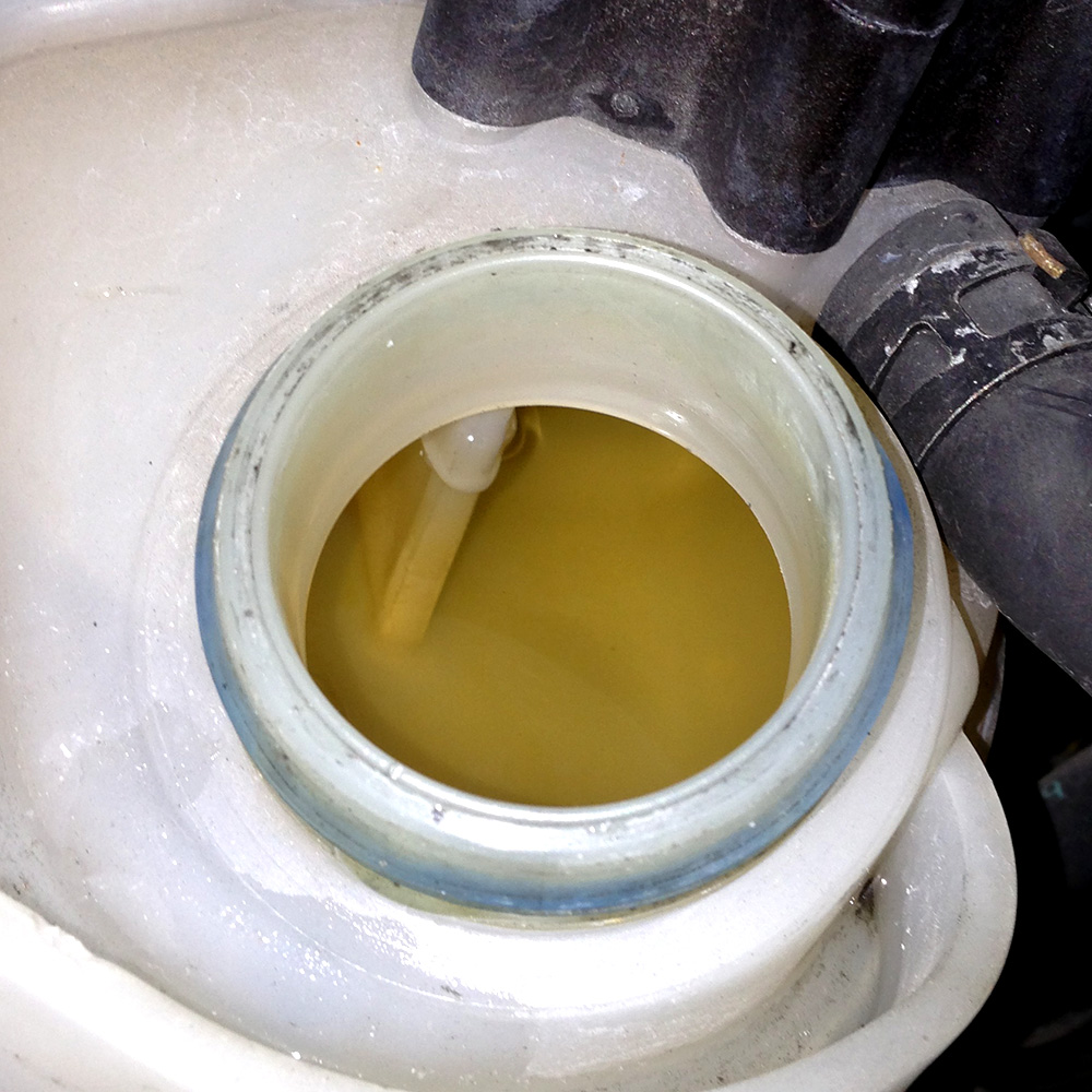

OK, took a few minutes and went downstairs to check this out. When I turned on the car, no smoke (just like earlier this morning and yesterday morning). Observations:
1- with the car idling, I removed the oil filler cap and even before lifting, I could clearly hear a air "intake/sucking" noise. The cap was very easy to remove. The car seemed to change idle, but ever so slightly, definitely not rough idling nor want to die out. So, removing the oil cap requires not much effort and just makes noise.

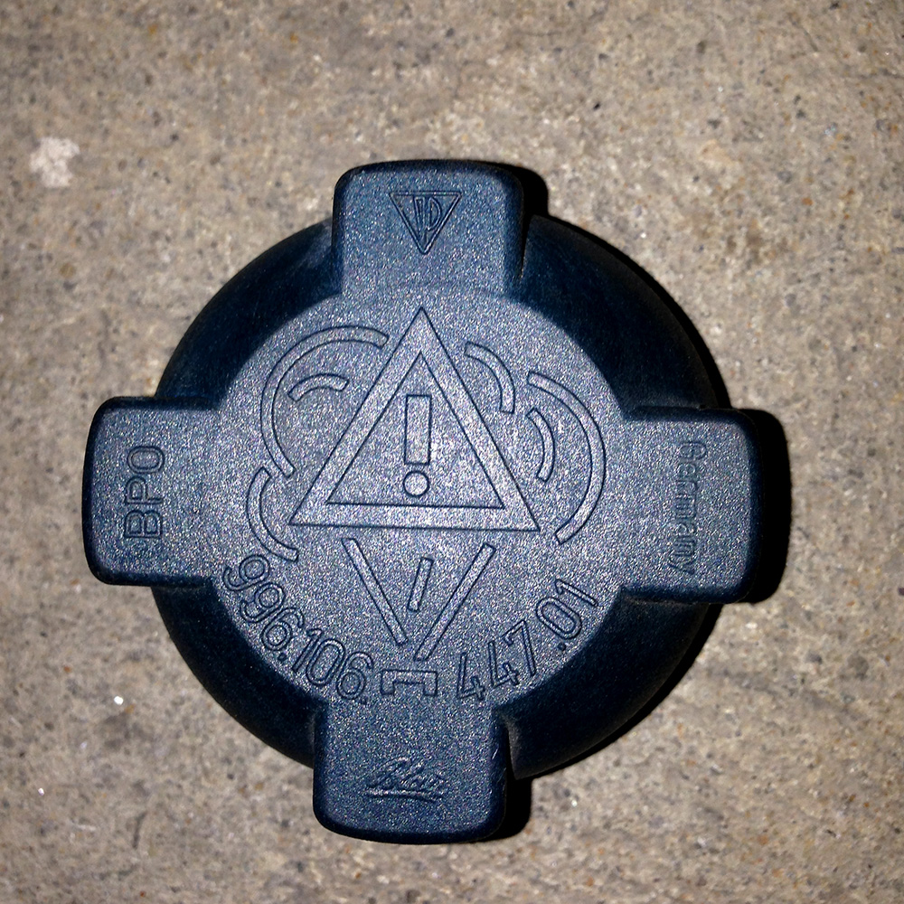

2- removed the coolant cap (sucker was on TIGHT!) and looked at it. Not really sure what to make of it. Does seem a very light, even, tan/dirtygreen color, but definitely no oil residue or drops on top of the water. I know oil and water don't mix, so i would have expected to see some sort of oily film and that was definitely not there. I would assume that if there is intermix, it would at least look like when you pour gasoline on top of water (think refilling your boat and you get overspill). The color is definitely not pink, nor "vivid" green, but perhaps it is a pink/green that has not been changed in a while, thus the color seen? I don't have the service records of the vehicle (dealer has it and wont release them to me as someone else paid for those services) so I am unsure as to when it was the last time a coolant flush was done.
Like they say, a picture paints a thousand words. See below.

I hate to say this, but it looks like the first sign of intermix. Is it thick? And if so, it might not ba a cracked head, it could be a bad head gasget, or the cooling system.

Will stick my finger in it later when it's cooler. Seemed to me that it was very thin and not thick/cloudy at all.

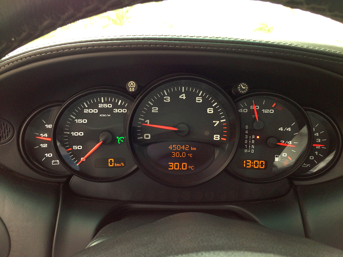

Regarding cooling system, I am actually amazed as to how cold this car runs compared to my previous 3.4 C2. This one takes a good 15 minutes to reach ±176º (since my car is Euro, it is labeled as 80ºC) and this driving in stop and go traffic in 90º+ weather. Only in really extreme hot days (100º+) have I seen the needle barely pass the "0" in the 80º marker.

I'll look at mine when I get home. One sign of intermix is there will be a oil film on the inside of the cap, look at it. Also, for grins go to an auto parts store and get the strips to test the coolant, it should be 50/50 and perhaps the previous owner mixed it too strong or it's too old.
