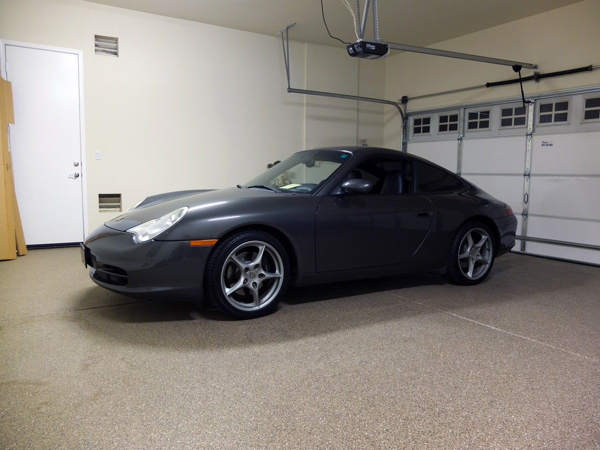

Proud first time Porsche owner here.
It's an '03 C2 with 75k miles:
Since I got it, I've been driving the sh*t out of it, love it! First time feeling the "Porsche experience". The RR layout really is quite special.

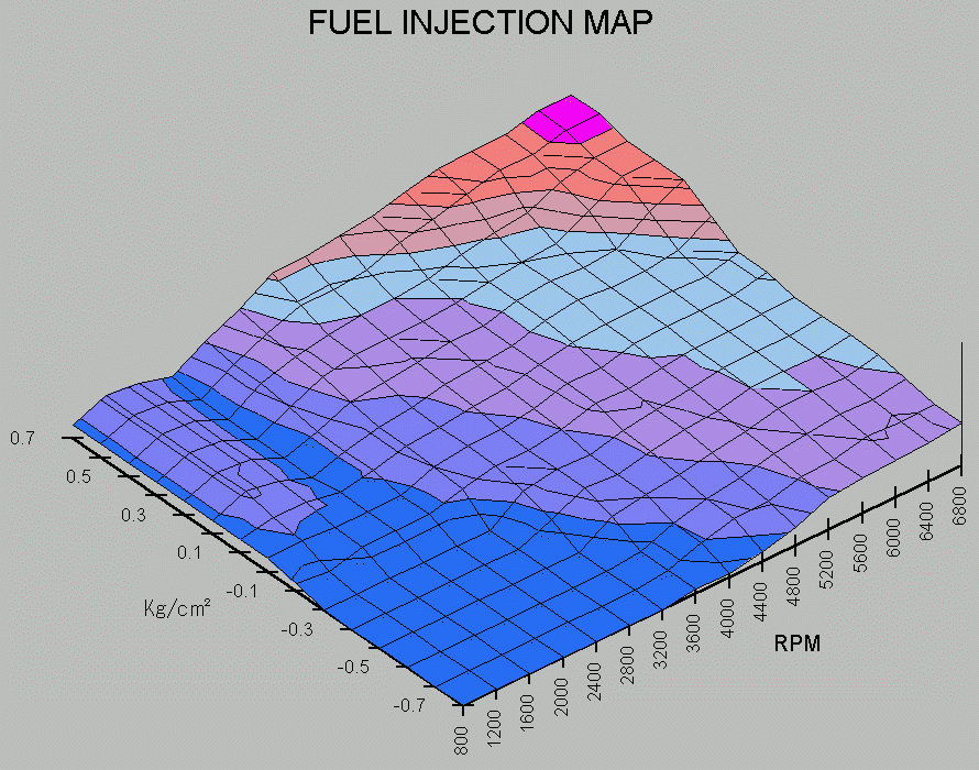

I do agree that maintenance is important, however, I think the way one drives the car has far more impact on the longevity of the IMSB, or any other parts of the engine. I come from a modest engineering background, and I've built and tracked a variety of cars. From my limited experience in car/engine building and ECU tuning, I've developed certain driving style quite different from the general public - one that takes care of sport/race engines.
I noticed that in general, most drivers think pretty 1-dimensionally when it comes to their understanding of "engine stress." When I say engine stress or engine load, one usually associates it with RPM. Most people know not to rev their engines high when cold, but there's another dimension to engine stress/load.
In any modern fuel injected engine, the ECU uses a 2 dimensional map to determine how much gas to give, and how much advancement in ignition timing. A typical fuel map looks like this:
The axis on the right is RPM. The axis on the left is engine load. For naturally aspirated engines, the engine load is typically the same as your TPS (throttle positioning sensor) reading, which is essentially how much gas pedal you give it. For turbo or other force induction engines, the engine load is typically the same as your MAP reading, which is the vacuum or boost pressure of your engine. The mountain you see is how much fuel the ECU is giving the engine.
As you can see, an engine can experience a lot of engine load while the RPM is low. Taking the light purple color band for example, putting your foot down all the way at around 2,800 rpm is equivalent to lightly reving to 6,800 rpm.
In summary, this is how I drive my sport/track cars, and I believe the below steps should greatly improve the life of your IMSB or engine in general:
1. When I first start an engine, I give it at least minimum 30 seconds before I press any pedals, shift into any gears, or even lightly move it around. A cold engine requires some time to circulate lubricants around.
2. If I'm in a hurry (getting to work), I would starting driving, but gently on the gas. I would slowly bring up the RPM to warm up the car, but never much engine load. I've met countless people who stomp their feet on the gas pedal on an cold engine, thinking it's okay because the RPM is low. The engine experiences the most load when the RPM is low, with the gas pedal all the way down.
3. I never give it any serious gas until I know the engine is thoroughly hot, as in, a good 15 minutes of driving later. Also - don't trust your temperature gauge. The temperature gauges on almost all production cars are extremely middle-heavy. Meaning, the gauge needle is designed in a way that it pretty much never moves. From well below the operating temperature of an engine, a stock gauge would already show that it's "hot and ready to go". At this moment there is still a massive thermal gradient between the hot and cold parts of an engine.
Once everything warms up though, I drive it hard. I would redline it, stomp on it without care, because I believe that's what these cars were designed and built to do. Drive it hard, it's good for the engine.
I just want to bring the engine load concept forward to other owners. When the engine is relatively cold, or worse, when parts of an engine have reached operating temperature but other areas haven't, excessive engine load can destroy bearings, seals, and many many other things.
Some say that the IMSB fails because the bearing seals leak over time, and engine oil dilutes the bearing grease. I'm sure there's truth to this also.
It's an '03 C2 with 75k miles:Since I got it, I've been driving the sh*t out of it, love it! First time feeling the "Porsche experience". The RR layout really is quite special.
