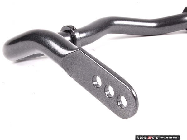

H&R Sway Bars. You can install coilovers and maintaine your current height, just because you have coilovers doesnn't mean you have to lower the car.

I would go with H&R Sway bars. A far as coilovers, I think it really depends on how many DE events you going to do and if you need to upgrade your suspension already due to age. For more information on the H&R Sway Bars, Click Here.

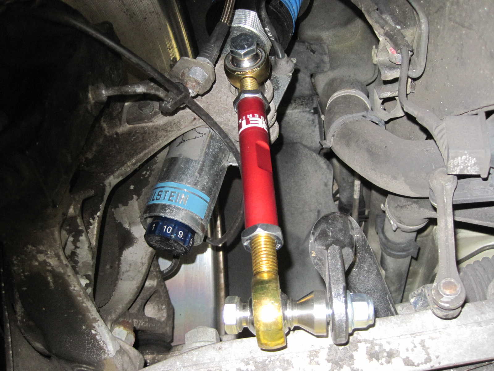

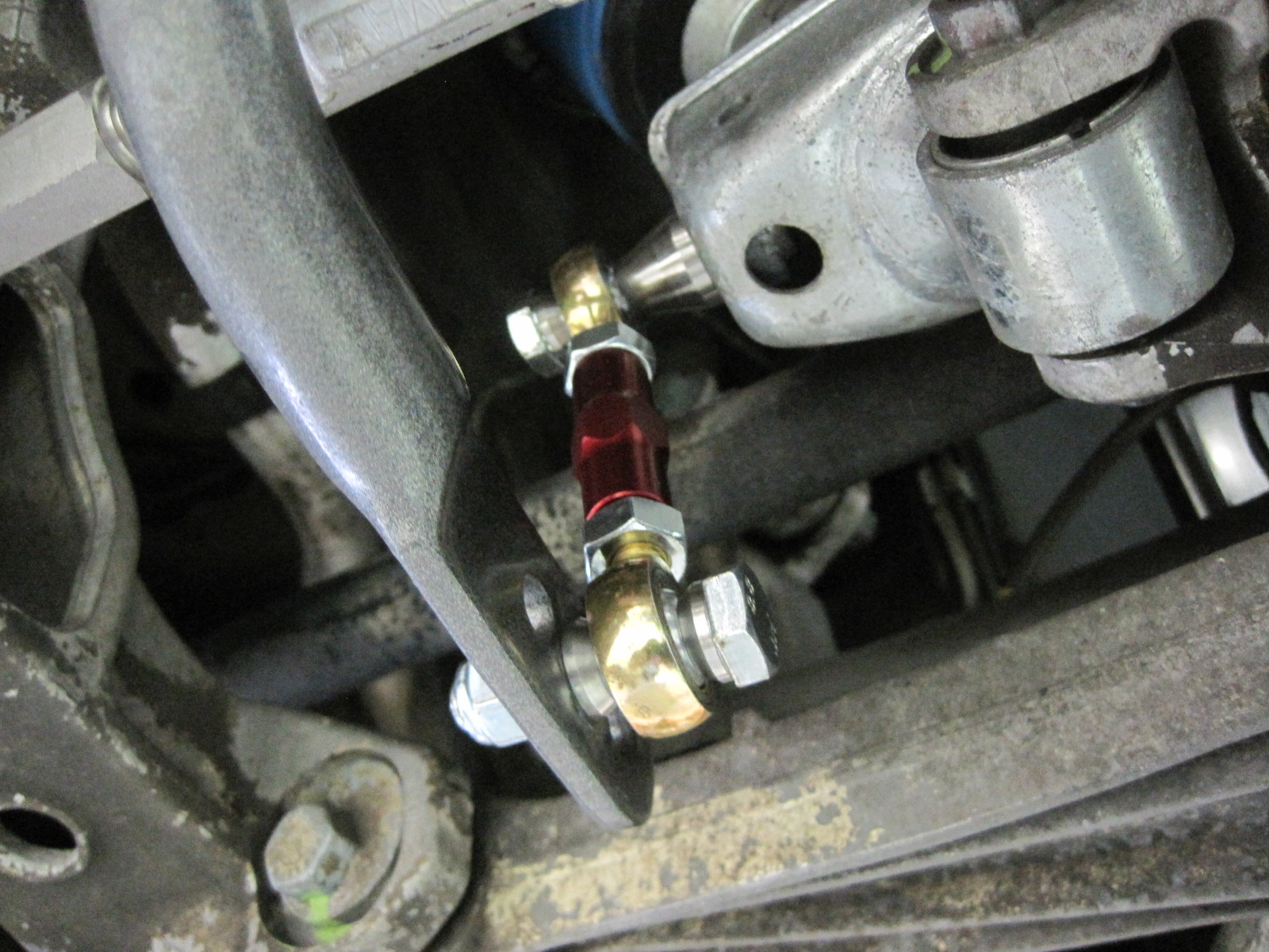

i like pss10s/h and r sways/tarret drop links,however 19 inch tires are wrong if your going to de events! car was designed for 18s,your concerned about lowering the car witch i understand however your not concerned about a rougher ride, sidewalls more prone to damage and the wheels themselves being scuffed etc with 19 inch wheels?anyway good luck de events are addicting and you will want to do plenty of mods! most important you will be learning to drive your car on a track!

smart! you wont be sorry ,the pss10s are fully adjustable,and very well made!

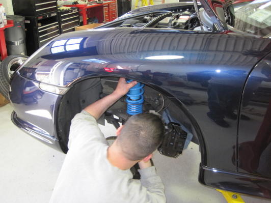

You can still find PSS9s used for about $1 -1.2K, an even buying all new rubber bits and bearings all around, if you DIY, you're in under $1700 + alignment. Installed my PSS9s in a day myself, but I have a lift and air tools, which helps immensely. I reused all the cup washers on the struts, (the only parts I reused) as they were crazy expensive to replace (like $70 a wheel!!), and I just used a run of the mill Harbor Freight spring compressor to remove the old washers. By far and away the biggest improvement inthe car I made, handling and ride wise. Absolutely love them. However, I don't think you can avoid lowering the car with any stock coilover design. Adjustable does NOT mean you can set them to any height you want. It just means they're adjustable over a range for F-R and corner balancing. For Bilsteins the range is around 7/8" to 1 1/4" (25 to 32mm) lower. Lets face it, most everyone wants to lower the CG for improved handling, (and looks). Go lower and you bottom out the strut, go higher, and yours springs will rattle/bounce because they are too loose. You COULD add solid 3/4"spacers to the spring perches to raise it, though, but you would have to have them made, or make them yourself. I also went with a used set of M030 ARBs, which complimented the PSS9s very well, and avoided the high cost of new links, which were as much as or more than the ARBs.
