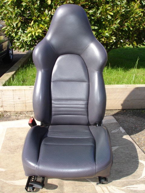

I have owned a 2000 911 with the sport seats for about 2 years now and no matter how i adjust them i can't get comfortable. I find the seat too narrow in the back area and the lumbar is not so great. I have considered taking them to an upholstery shop to have foam shaved or pulling them out and getting a set of aftermarket seats.
Wondering if anyone else finds problems with these seats and what you ended up doing?

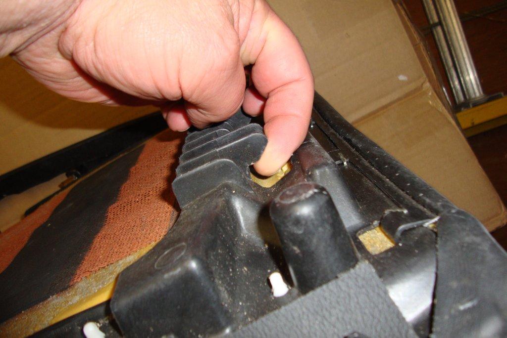

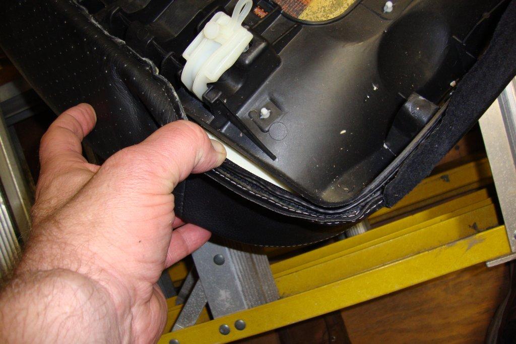

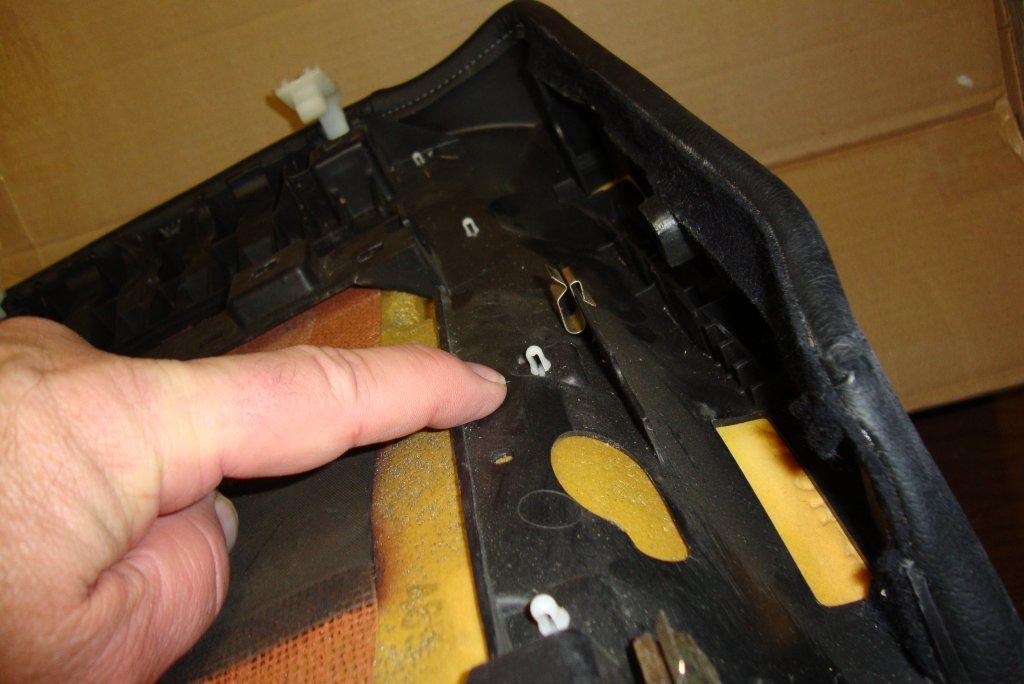

Just pull the seat bottom out take the cover off and add some flat firm foam to the pan that will get you up out of the narrowest part of the pan a little.
Unscrew the two Phillips screws on the bottom of the switch escutcheon.
Pull the lowering lever off the side.
Pull the escutcheon out at the bottom slide it down slightly to get room to disconnect the switch connectors.
Locate the two nylon pins that hold the clamps tight under the front of the seat.
Pull the pins, unclamp the clamps and raise the front of the pad to get at the wire connector.
Slide the side of the connector to the side to release the connector.
Locate the seat belt connector, different color two socket connector in the main connector.
Slide the little door open (it is loose don't lose it) pull the seat belt connector out of the main connector.
Unclip the seat belt harness from the metal guide clips on the seat pan.
Unclip the wire on the other side of the pan.
Take the seat bottom out.
The cover with the foam is very easy to take off.
see the pic.

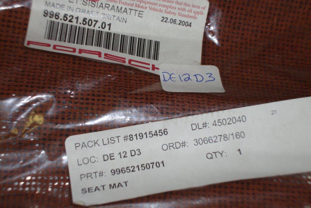

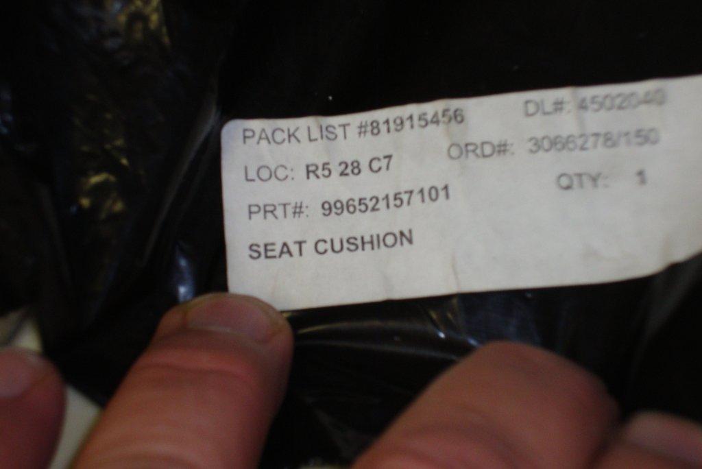

You could get a new foam and replace your tired old one. This is the part number for the sport foam. It cost me $75. And the mat, mine was stretched and had a cut in it.

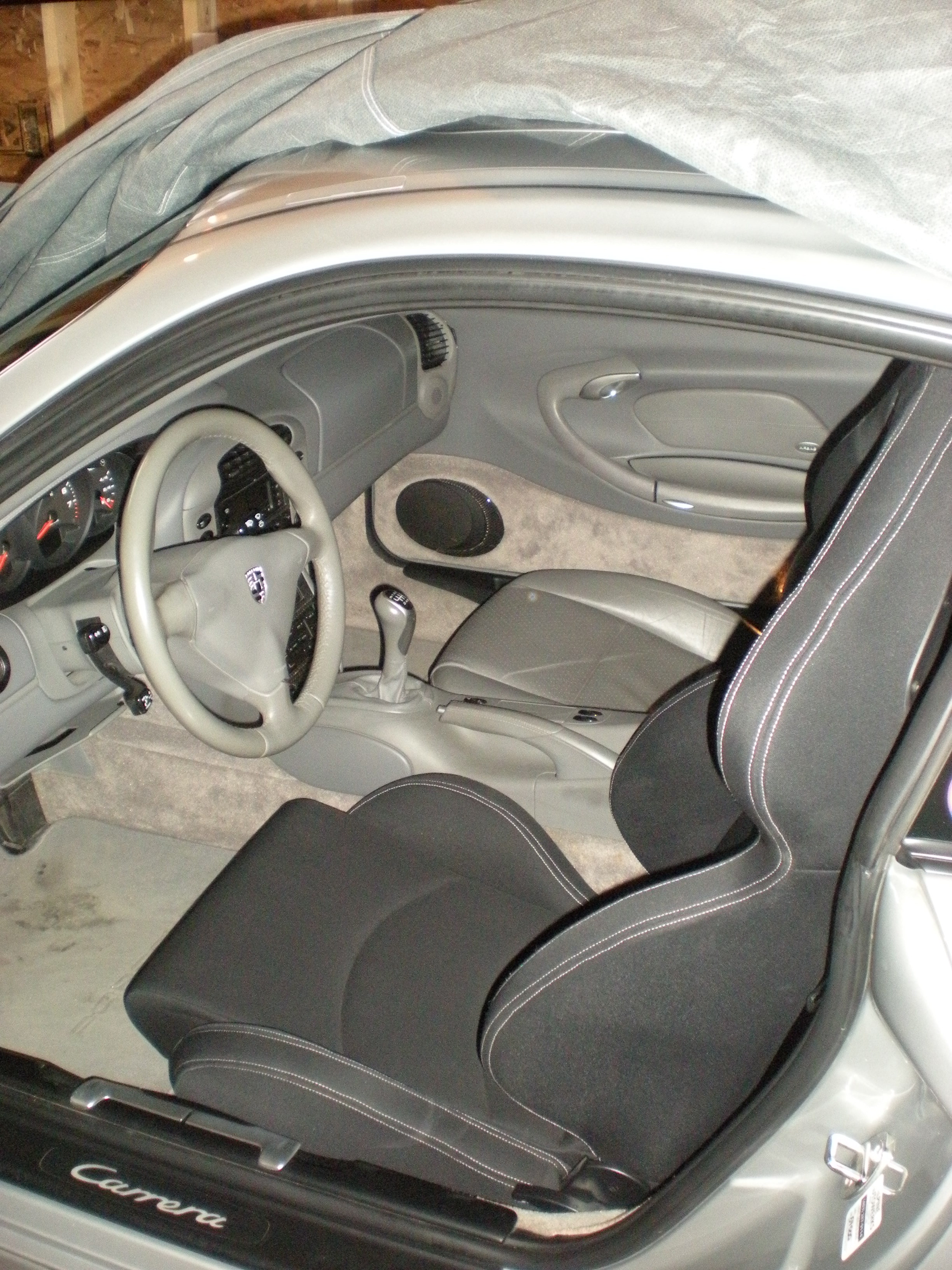

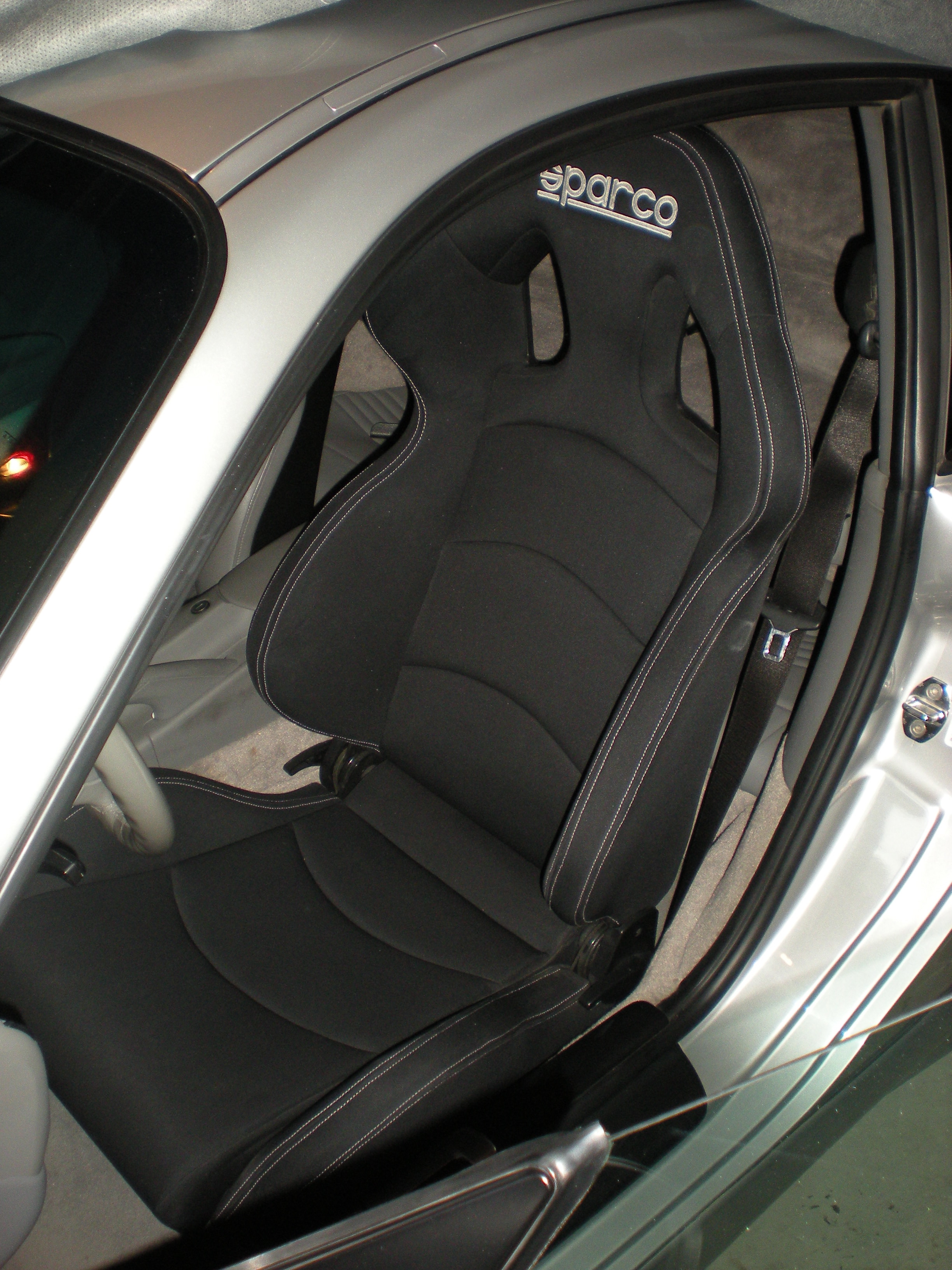

found a great deal on Kijiji (like craigslist), they are brandnew and feel fanastic, dryfitted them this morning. will be installed next spring.
