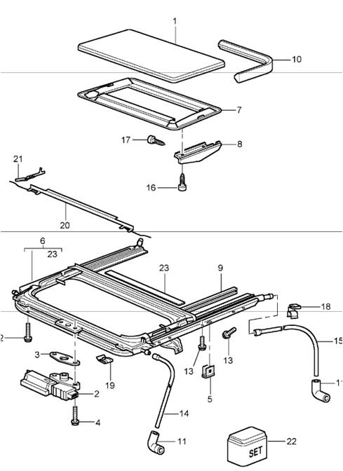

My sunroof works just fine. It opens and closes with no problem at all EXCEPT that when it opens and closes there's this annoying screeching/screaming sound
I tried listening in closely where the screeching noise was coming from but it seem like it's everywhere (sides and back). So do you guys know where I can apply a little of WD-40 or white lithium grease perhaps to stop this? I don't know where to do it. Maybe someone can point...
Do I have to take off the headliner to access the parts I need to lube? How do I take out the headliner? Anyone who can share their experience? Thanks!

It looks like the motor is item #2 in your diagram above.
Read this: http://www.pelicanparts.com/techarti...DY-Sunroof.htm
I think this article will suffice and give me the confidence to replace the motor by myself. Thanks again! Will update this thread When I finish replacing the motor. Got a good deal with a used sunroof motor off ebay for only $120 bucks!
