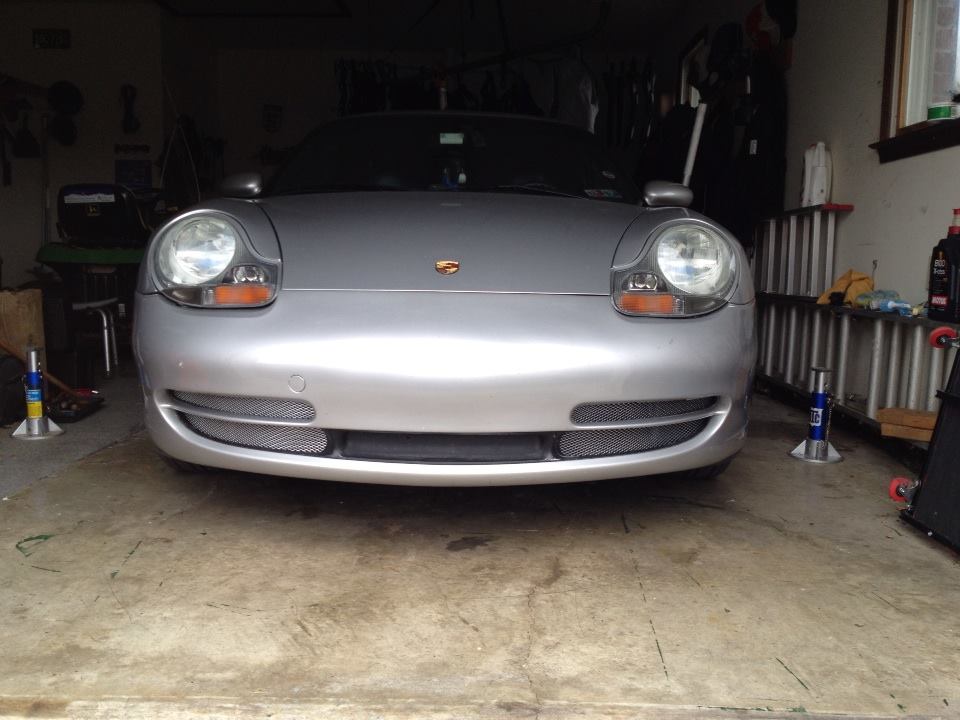

So I finished the job on my 1999 996. Remove the bumper as here

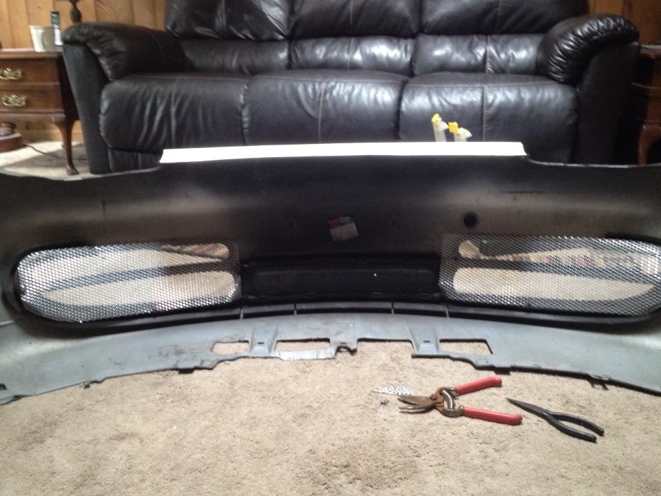

Then take the bumper on a carpeted floor. Buy a
leaf gutter guard from a hardware store. Cut it in
half with tin snips each 18 inches long. The gutter
guard is 3 foot long. The mesh is very pliable and
can be bent into shape by hand. I used three screws
on each side bending the mesh around the slots leaving room
for the air scoops to sit in place for when the bumper goes
back on the car.

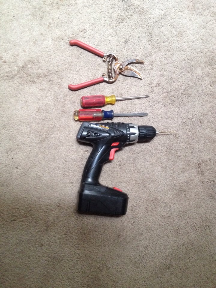

Here are the tools you will need.
here is the inside of the bumper in the living room on the carpet so not to mark the paintwork.

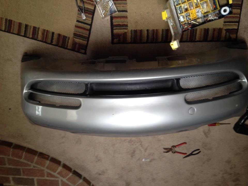

Here is the front before putting it back on the car.
And here is the finished job. I can always spray paint them black if they tarnish but like the silver color.
Check this site out at $275 a pop which cost me under $5.. DIY job start to finish 2 hours tops. I am 72 years of age and found it a very easy DIY job. I don't like posting links unless I think the 996 owners are being ripped off and this time I have proved it.
pelican... http://www.pelicanparts.com/cgi-bin/...2532%2520%2520
http://www.rennline.com/PDF/E123_install.pdf

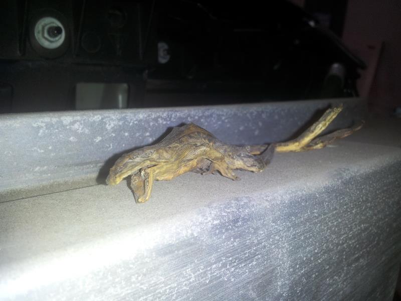

Found this mummy in mine.

Is that a lizard? That's what you get for being insured by Geico haha
