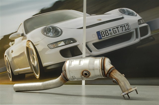

From pictures I have found online, it looks like all part numbers starting with 996-113-03 have the O2 sensor "in" the cat - meaning in the bulky section. Of course, that's what Porsche dealers say my car has, and of course it's the least common and most expensive. From the sonnen oem parts catalog, it looks like that cat fits all 2004/2005 models except the GT3. I guess in 2004 Porsche moved to a single cat for all models?
The O2 "in-cat" sensor for other 01+cats is a good 2 feet away, so I am guessing I am just screwed and have to use 966-113-031-01/02/06 (as far as I can tell -01, -02, and -06 are the same part).
That looks identical to mine, not to say the internals are the same. '04 C4S. Has two O2 sensors, one pre and one in the body.
