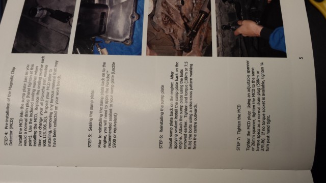

Has this happened to anyone? Happened before I went away on holiday and just got around to posting about this now.
I had an IMS Guardian installed. There was a leak coming from the sump plug, on undoing the plug it cracked
It's been a couple of weeks now and I can't even find the plug to take pictures but it was all very weird.
Bought the kit from an official distributor in the UK like 6 months ago.
I remember installing it and definitely torquing correctly. Searching hasn't revealed anything though.
Are there spare plugs available?

Tightening the socket greater than 19lb torque will damage the sensor. Bad news.

Well the instructions clearly state 37ft....

IMS Guardian Jr installation instruction
http://www.theimsguardian.com/wp-con...structions.pdf
I bought the IMS Guardian Jr for my 2005 997. This was the instruction that came with the package. It strictly instructs to tighten the magnetic drain plug with the special socket (allowing wire to pass through) no tighter than 19lb/ft.
996 and 997.1 engines are identical. I don't see why the instruction would be any different. Porsche OEM drain plug needs to be tightened to 37 lb/ft. However doing so to the magnetic drain plug (hollow design) would crack the sensor and damage the module. Try reconnecting the wires after drain plug is in place. You should hear a long beep sound from the cabin to assure the system is in working condition.
Always talk to your mechanic about this IMS guardian Jr drain plug torque specification. One unlucky trip to the local Jiffy Lube / or any uninformed independent shop for oil change can easily damage the IMS guardian Jr module.

Interesting, will take a picture of my booklet tomorrow

These are the instructions I received....
Tighten securely using the special socket included in order to protect the harness. Torque the sensor to a MAXIMUM of 19 Lb/FT!! The Magnetic Chip Detector Sensor will be permanently damaged and compromised immediately if tightened beyond the specified torque. DO NOT utilize the OEM torque value for the stock drain plug! We cannot stress this point enough!

Pfft, called my mechanic and he couldn't find the cracked sump plug.
Torqued to 37ft like the manual when it should actually be 19ft according to Jake Raby.
$120 for a new plug. Not sure who the developer/manufacturer of this kit is but least professional IMO. Can't even get your own instructions correct with the torque and then when it breaks it's ludicrously expensive for a new one.
Quick google and I wasn't the only one with a leak.
http://forums.rennlist.com/rennforum...g-leaking.html
