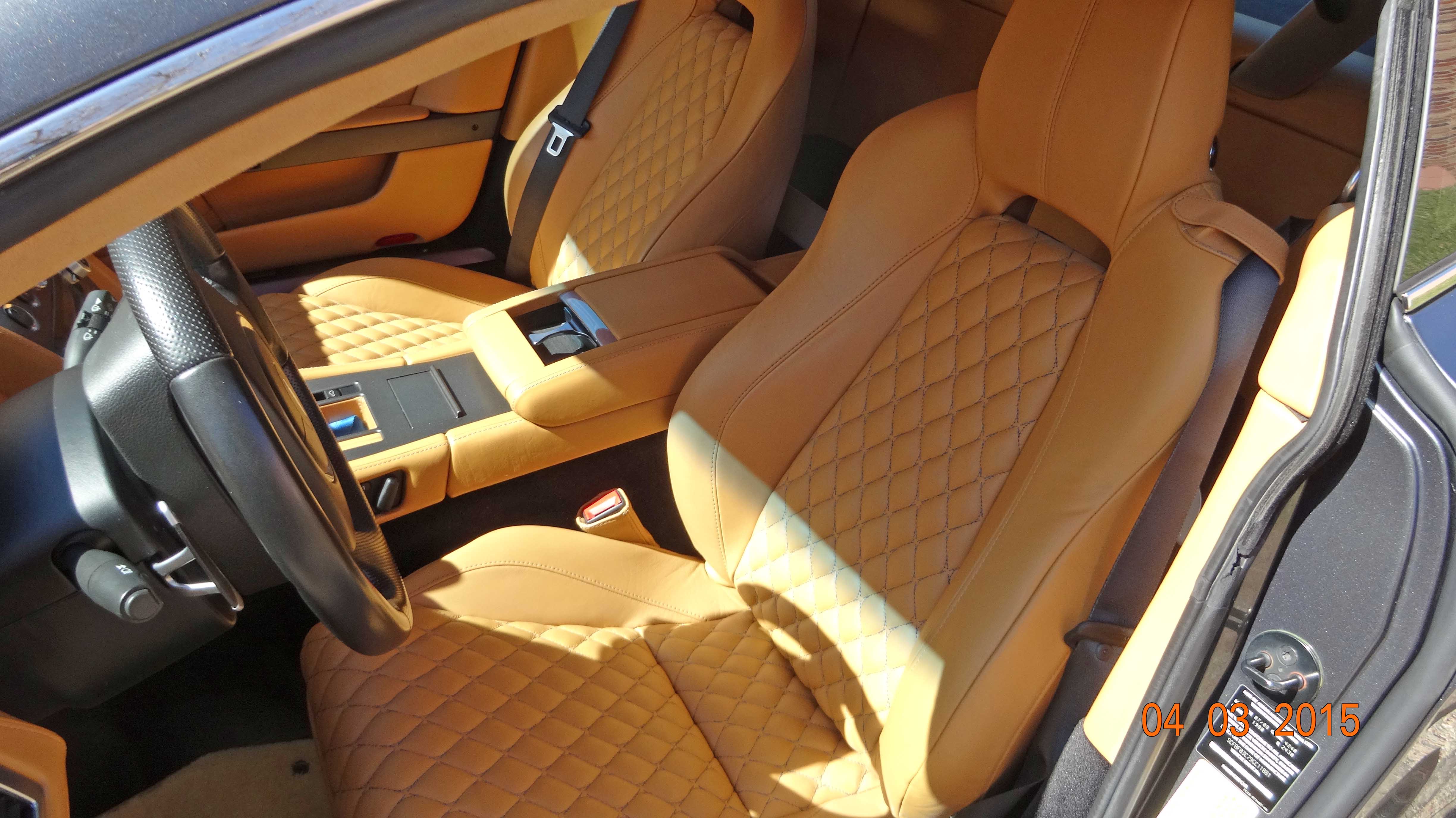

Thinking of going custom to achieve this end result:
