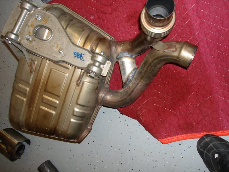

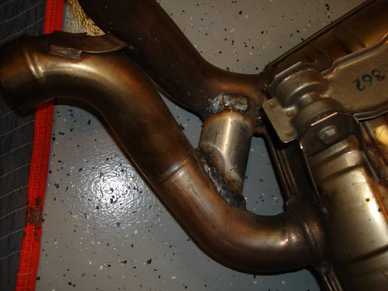

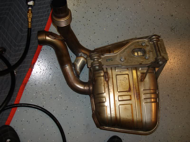

If you don't have to change out the mufflers go for Fisters/PSE Hack. If you need to change try SpeedTech, Fabspeed or MaxSpeed out of Canada.

Your best bet (if you dont want to spend a fortune) is to get OEM and do the Fister/PSE Hack. I have a set of OEM mufflers if you're interested PM me - I'll give you a good deal. As far as sound, I replaced my OEM for fabspeed, if you're concerned about loudness, I would advise you stay OEM - I'm even thinking of switching back. You can find OEM for much cheaper than aftermarket on eBay. If price isn't an issue, then I'm sure there are a bunch of different combinations out there to suit your needs.

Go to an indy or muffler shop, show them the pic and say "do this."

Yes - i will check the mufflers and see if they are oki. If they are i will do the hack ( thanks for the pics - great help ). If i need new mufflers i´ll let u know. Unfortunately its expensive to ship to Iceland but lets see.

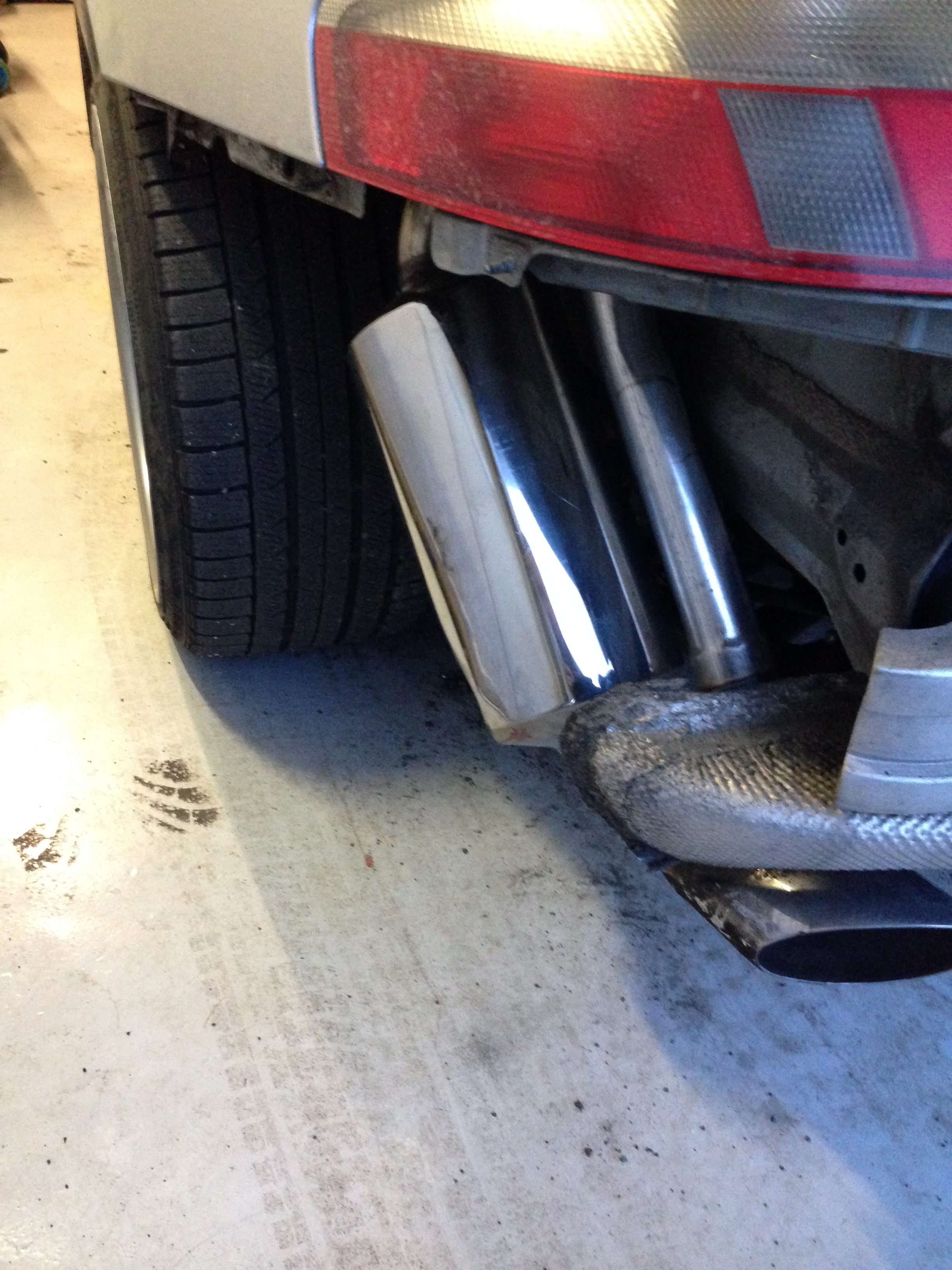

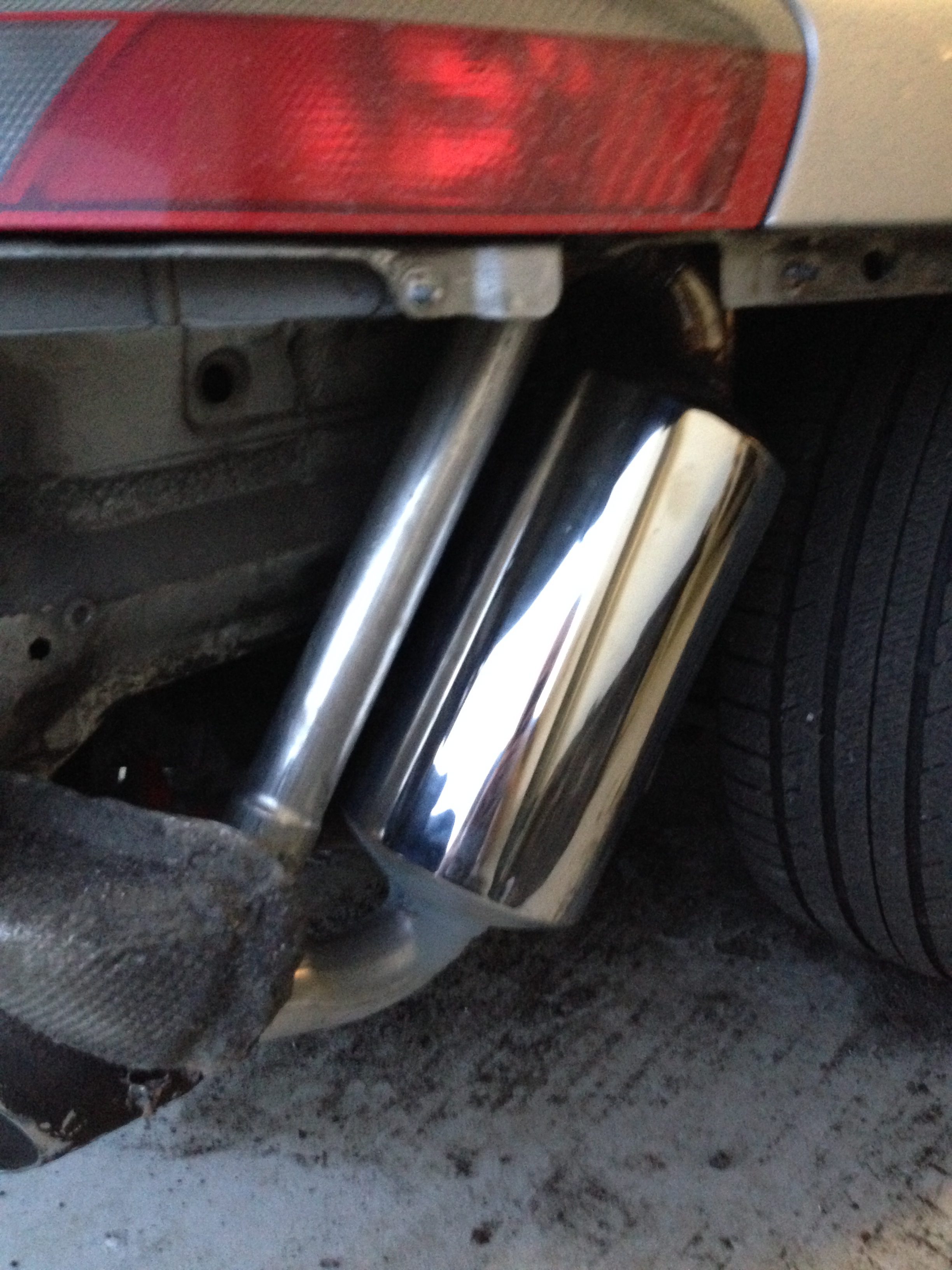

So - just got her today after installing the new exhaust system.
As the old mufflers were rusty and shipping stuff to Iceland is SO expensive i talked to one of the most experienced welding / exhaust guy there is here is Reykjavik, Iceland. Been in the biz for 25+ years with many great mods in his belt. We decided after surfing the net to do hollow stainless power mufflers and x-pipe. And what a difference i felt when driving from his shop! It does sound mild but as soon after it hits 3500+ rpm it gets throaty (but not too deep). Its just the way i think i always wanted it to sound.
So - before i did the longer way to work, now i´ll do the extra long way to work, ha ha.
Just feels great and im happy with it.
