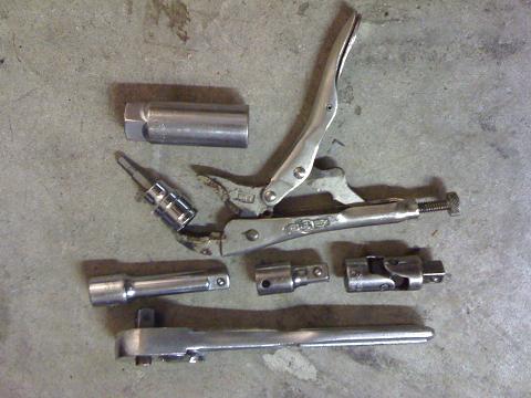

I didn't remove the manifolds and these are the tools I used. The only thing not pictured is a small socket to remove the heat shields:
The vice grips were used to hold the allen wrench socket to get one bolt on the right rear coil pack where clearance was tight.

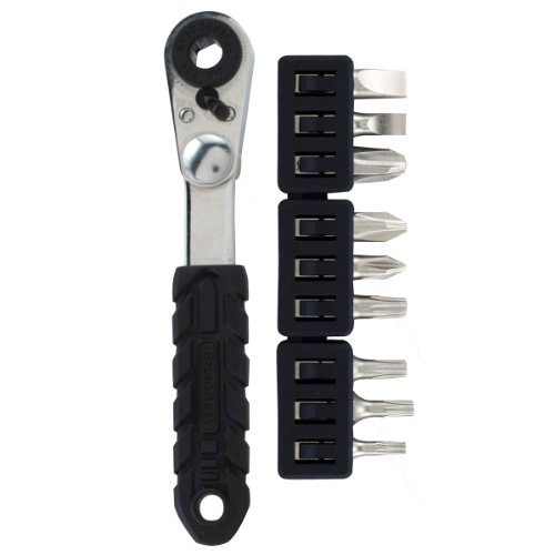

Mini ratcheting bit driver for an easier time with the torx bolts on the rear-most coil packs. Earlier year 996s use allen head bolts instead of torx bolts, I think much easier to deal with. A standard 3/8" torx bit socket is too bulky for the limited space, no chance at all with a torx screwdriver. 'L' shaped torx wrenches (similar to the cheap L shaped allen wrenches that come with every craftsman tool set) might also work well.

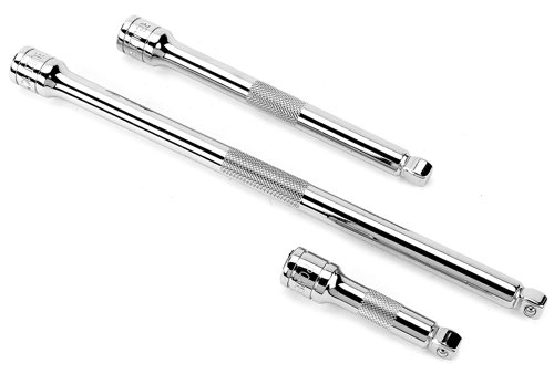

Wobble extensions if you don't already have them...

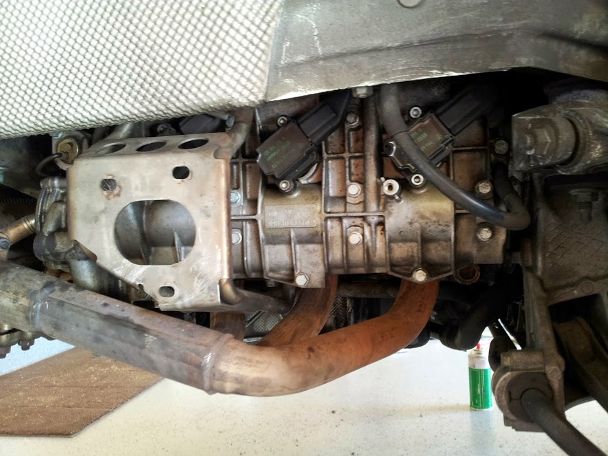

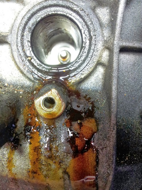

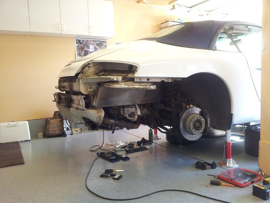

I agree with the rest of the group after the muffler and heat shield is off, you will have very easy access.
Did mine last year 1/2 hour to get the bumper and muffler off. Decided to clean the engine at the same time.
