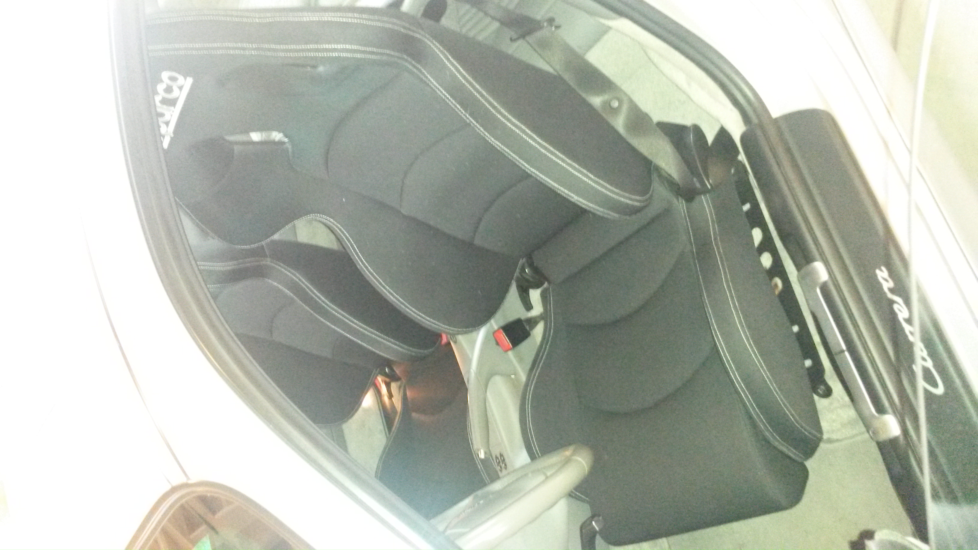

Old Mar 18, 2014 | 09:21 AM
bgx-9101's Avatar
Joined: Sep 2013
Posts: 40
From: Calgary, ALberta
Rep Power: 14
bgx-9101 is infamous around these parts
6ta1 you were correct it was not rocket science, got them installed over the weekend.
they feel great, although with Calgary weather might be another month before i can get the car on the road.
