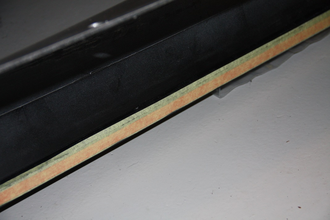

The partnumber for the kit you are looking for is 000 044 000 37
Here are som pics from when I mounted mine.
If you need any more help, let me know.

Yeah, that shouldnt be a problem. Do you have the holes, shown in pic number one? Otherwise just drill some holes, and screw them in

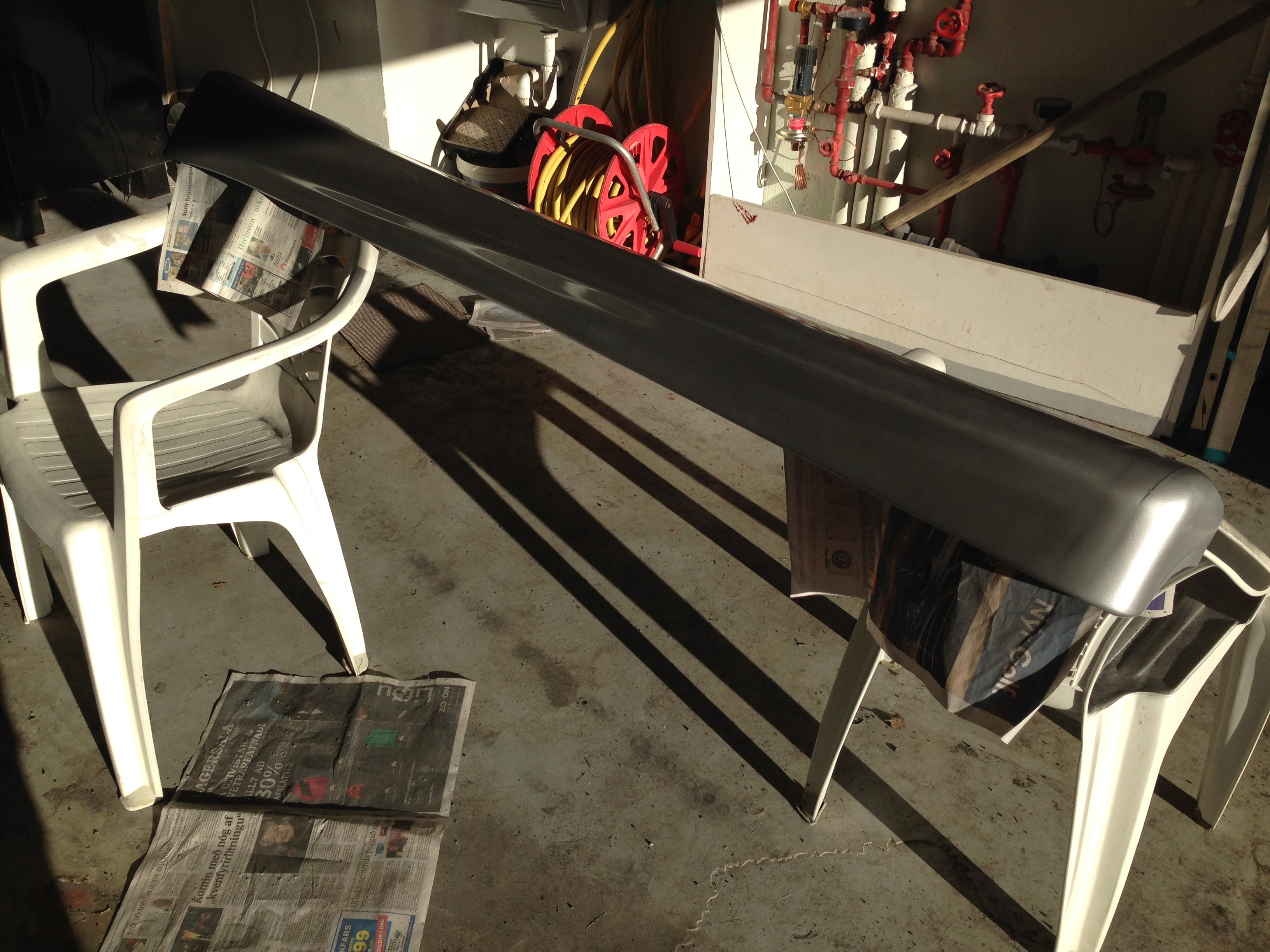

Here are some pics - not sure if you see it but i trial fitted the skirt and there is this small gap on rear.
Now I c what you mean. Well use some 3M tape as shown on pic number 3. That should solve the problem!

My advice would be to find a great body shop (everyone should have one) to do a professional install OR return them (which you can't do once you've don any DIY work to it). The way it is, I would never put it on my car. It either hasn't been properly adjusted or manufactured.

You are very correct. With the proper fit/trimming it should be fine. You'll probably have to reduce the high (front) half to allow the rear half to sit flush. I wouldn't use any type of filler.
