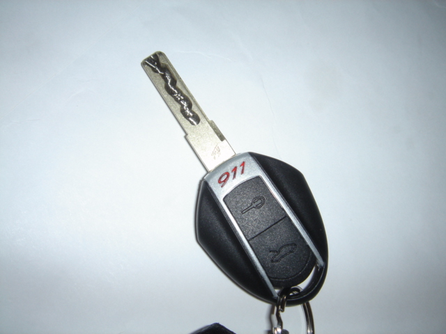

Some answers...
Q1. Work on a 1999? I do not think it will work with a '99, at least according to the Suncoast website. I suggest calling ric at Suncoast directly
Q2: How easy it is? Very easy.
Step 1. Pry open the existing key using a flat plade. I used a small srewdriver.
Step 2 lift out the circuit board/battery combo
Step 3. To remove the key blade, use the same screwdriver to lift a small tab on the right side of the plastic shell. There is a small spring. the spring might pop out but just lift the tab. The key blade will pull out of the shell easily
Step 4. Remove the tiny microchip on the left side of the shell. It's about 3/8" long and the diameter of the tip of a ballpoint pen. It just lifts out of it's cradle. This is the chip that lets the car start. Do not forget this step; the car won't start w/o the chip in the key!
Step 5. Assembly:
insert key blade; it will lock in place
place chip in cradle on left side of shell (maybe use something tacky to hold it in place...)
place circuit board in position & click both sides of the shell together
Enjoy the new key; both buttons work as before
no more than 5 minutes once you get the idea of interior layout of the shell
Hope this helps

got the key head, it looks really nice~~
