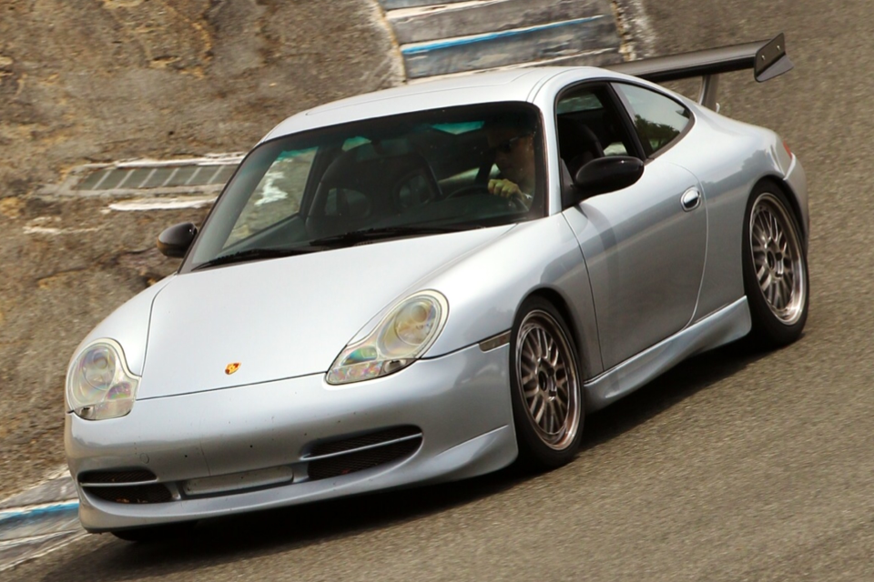

Hello all. I've been lurking and slowly building my 2000 996 into a poor man's GT3 RS:
Recently, I picked up an old TPC supercharger kit from someone who took it off their 997 for cheap. It's the later kit with two extra injectors (controlled by Unichip.)
I'm looking for installation instructions and a Unichip tune for the kit.
I know these may not exist at this point, and I'm reasonably experienced with projects like this, but don't want to reinvent the wheel if these things are available.
Any help is appreciated.
