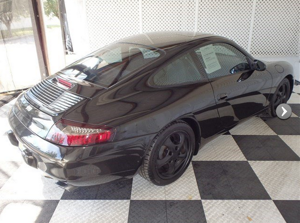

It's a 2000 and the price is just too good to be true even with the high mileage. It almost makes me think that something is wrong with the car. It's from a dealer so I'll have to follow your advice and check the car out 110%. Anyways, thank you guys so much for your advice! Hopefully the next time I post, I'll be posting pictures of my new 996 lol.

The dealer is asking just under 13K which does seem a bit strange to me. Luckily the shop I work with is very willing to help me. In my opinion, the car it's self looks great. Aside from the slightly milky headlights and the stock ride height I think it would be a great start.

I spy 17" black painted wheels, eBay taillights.
Make sure it's clear title with no signs of accident damage or replaced steering wheel.
Take a pic of the engine serial number(underneath driver's side next to the headers) to see if original or not.
If it's coming from a dealer, see if they can at least offer a 6 month warranty on it if they don't have any maintenance records.

I hate the wheels, but if everything checks out I was offered a set of sport edition cup wheels for free. The taillights I don't mind at all.
The car has a clean title and the dealership offers a 6 month warranty along with a 5 day money back guarantee if I don't like the car.

I hate the wheels, but if everything checks out I was offered a set of sport edition cup wheels for free. The taillights I don't mind at all. The car has a clean title and the dealership offers a 6 month warranty along with a 5 day money back guarantee if I don't like the car.
Painted bumperettes....the car was probably owned by an enthusiast. Get a PPI. 13k is a good price of it checks out..
...or repaired from a rear-end accident, which might explain the replaced badge and tail lights as well.
