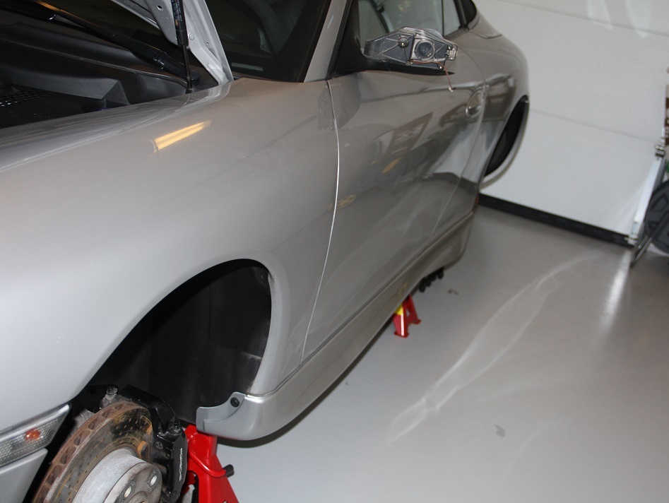

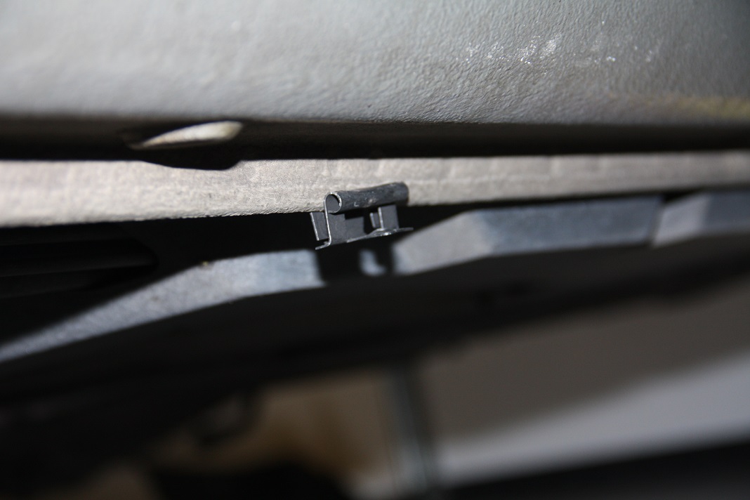

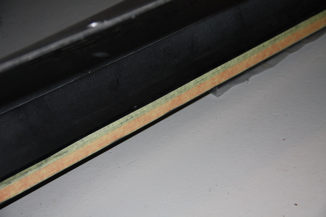

Are the skirts oem? If so;
You just use the clips under the car that attach the skirts below the car, then you screw in the screw at the front loose, remove the 2sided-tape and mount the skirt to the car. Tighten the other screws in the back in the front and you are done! The skirt will align perfect, and stick really well.
Pics are from when i mounted mine on my cab. And yes I have the same rough surface
