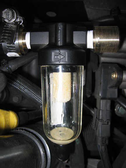

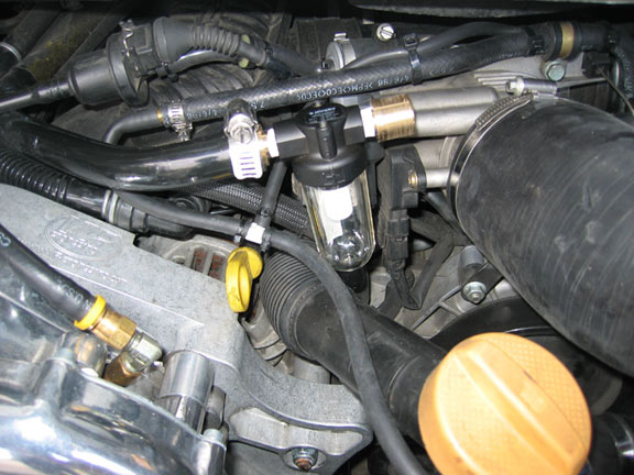

Originally Posted by Mother
Nice setup but the in and out lines look smaller then the min 3/4 - 1" you are most likely using now and I did'nt see specs of the flow it can handle, or how do you know when the filter if it has one is dirty and can it be drained back to the crank (if so does it come with a checkvale for ths purpose)? I forgot the company I contacted but there minimum for 420 hp needs to flow min 14 CFM. If you can elborate I'm interested. I apologize if I seem short but I just got back from trying to find a new colgne for myself and all I came back with was a headache.
after some more research, it appears the oil from the crankcase breather is a common problem with boosted/high HP cars. the oil is in vapour form so when it hits the intercooler it forms into liquid and pools and eventually decreasing the IC efficiency. many ppl have used a catch can for NA cars as well. although oil is not accumulating in the intake pipoes of NA cars, the oil vapours effective lower the octane rating.
here's my ghetto catch can, courtesy of some s2000 guy and home depot .
the catch can is actually an air compressor filter w/ 21 scfm of flow (is that the same as cfm?). it's about 4~5" in length but because of the cramped quarters i still had to remove the engine compartment fan. i probably will relocate it so i can retain the fan. the fittings i attached to it are 1/4" ID but with the 21 SCFM i figured it would be ok.
right now i have it venting to the atmosphere. the filter looks like it's doing it's job as there is no oil spray from the exit of the filter.
the oil trapped is only from 25 miles of driving, ~6 seconds of full boost, and no hard cornering... just commute driving. looks like i'll be emptying it rather frequently.
That's pretty cool. I'm amazed it caught so much oil after only 25 miles.
I bet if you'd had this that day you convinced me to buy an SC setup it would have have been full.
I think I'll look into installing something along those lines, anything to keep that cooler in the clear !
the catch can is actually an air compressor filter w/ 21 scfm of flow (is that the same as cfm?). it's about 4~5" in length but because of the cramped quarters i still had to remove the engine compartment fan. i probably will justrelocate it so i can retain the fan. the fittings i attached to it are 1/4" ID but with the 21 SCFM i figured it would be ok.
I LUV the smell of inspiration in the morning.. My understanding is SCFM is different, means that filter will flow 21 SCFM at 14.7 PSIA, 68Deg. F and 36% relative humidity in other words it's corrected and just straight CFM is not. Your results may vary as those parameters change, but it should be plenty. I looked at doing it that way (and looks great and visually maybe checked) but was worried that the 1/4" in size was to small and would cause back pressure which I never confirmed, I even contemplated redrilling the size to 3/4 " at least for piece of mind. If it works what the heck and Home Depot is a great backup Porsche parts outlet. I suppose if you get oil coming out the oil filler neck then it's producing to much back pressure, now if your feeling bold tee off to your SC drain with a inline checkvalve and I can live vicariously through you.
...now if your feeling bold tee off to your SC drain with a inline checkvalve and I can live vicariously through you.
i was thinking the same thing.
