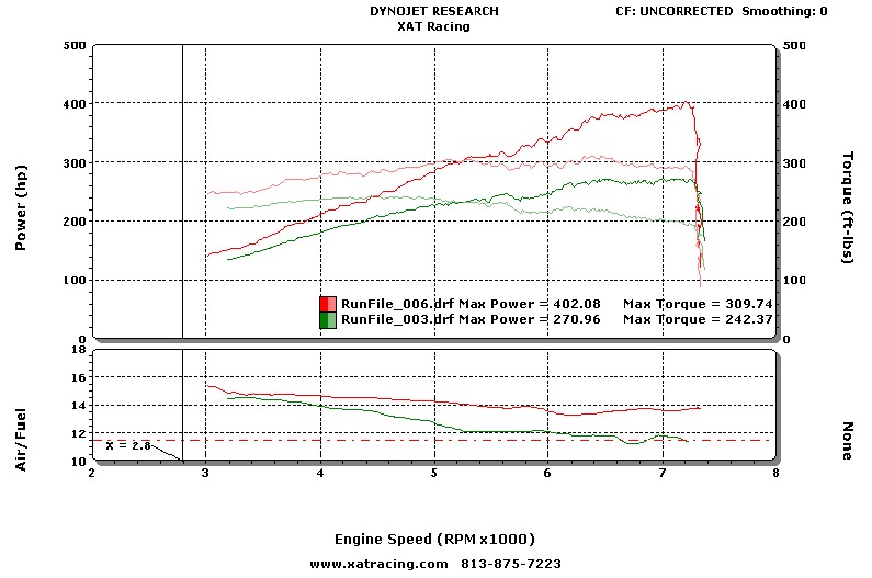

Hot off the presses. Here's the "after" dyno run. I need to get all my dyno runs emailed to me at some point, and for some reason they did not overlay my best "stock" run. It was close, so it's good enough for this comparison.
Not too shabby though. Over 400 uncorrected HP to the wheels. It was actually considerably lower with the corrected numbers so we went with the uncorrected. Nice and cool out today (low 80's)with low humidity.
The only issue, and there may not really be one, is the air fuel ratio. The stock run was spot on to what stock should have been, but this "after run" shows a lean condition. Their AF meter may be out of calibration though.
I am considering adding a boost/AF guage. Any recommendations?

Any info on what a/f Evo shoots for?

Should maintain stock ratios. Based on the fact that there were no cel's or serious power loss, it's probably a mis calibrated AF sensor.
