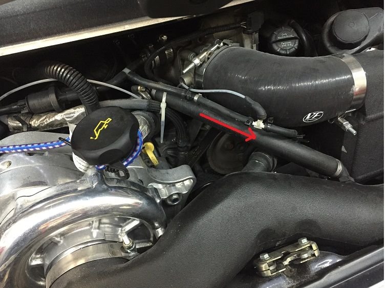

All,
Those that have installed an oil catch can in their VF supercharged 996, can you confirm the air flow is accurate in this picture.
Also, just to confirm that is also the right line to do the install into -- the larger of the two hoses of course where the arrow is.
Thanks!
Cheers,
Aaron

Aaron. Yes, I believe that is the correct hose. I've been thinking about doing the same. This one is a bit pricey, but I like that it offers 3/4" hose barbs. http://www.42draftdesigns.com/Ultima...Can_p_288.html
Have you chosen a catch can yet?

Ya I'm also trying to figure out if that is the airflow direction, as that is important when setting up some catch cans.
I'll find where I got mine and update the post, I didn't go with something that fancy...

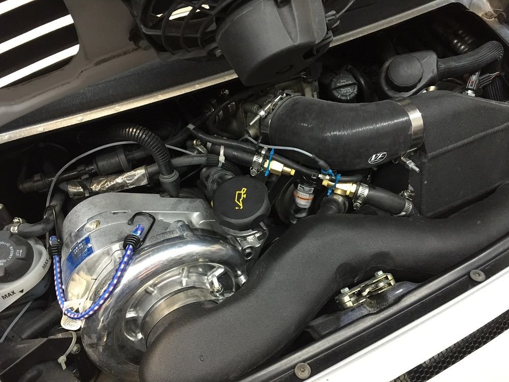

Mine if very similar to this (same brand, slight different design): http://www.cjponyparts.com/steeda-oi...014/p/5553714/
I plan on putting it inline as there is enough clearance and access to empty it -- without being near the pulleys, etc.
Some of the huge cans seem way over engineered. This may be too small, and if so I'll upgrade to a larger one. But I think it will be fine if I check it on a regular basis and empty it.

I would still like someone to answer my original question about air flow direction being accurate. However, I pressed forth assuming it was correct -- it is an easy change if I need to swap the direction.
Anyways, this is how I netted out... it tucks in there nice, easy to see the levels and empty, and it all fits when the oil filler is put into place to clear the fan on the decklid.

Originally Posted by Purplxd
PS if anyone would still like to answer my air flow direction question that started the thread, that would be swell.
I'm no expert, but here's my take:
Your first photo, with the red arrow, is correct. The SC is creating a vacuum, thus "pulling" air from anything in front of it. To prove this is working correctly, referencing the photo in post #7, remove the left side of your catch-can hose, put your finger on the catch-can barb. Do you feel a little tug? Can feel anything? Light a piece of paper, or something similiar, hold it in front of the catch-can barb opening, and see if the smoke is "pulled" into the catch-can.
Air flow direction is: from filter > to SC > to intercooler > to throttle-body
Old Mar 26, 2015 | 11:40 AM
Purplxd's Avatar
Joined: Sep 2008
Posts: 942
From: Vancouver
Rep Power: 65
Purplxd has much to be proud ofPurplxd has much to be proud ofPurplxd has much to be proud ofPurplxd has much to be proud ofPurplxd has much to be proud ofPurplxd has much to be proud ofPurplxd has much to be proud ofPurplxd has much to be proud of
Yes, same analysis I had based on air flow. The main air flow will cause a vacuum effect as well so it is just the logical direction. Also if you look at the stock configuration, that is the return line to the throttle body, so it all makes logical sense.
I'm just one of those guys that confirms things twice.
