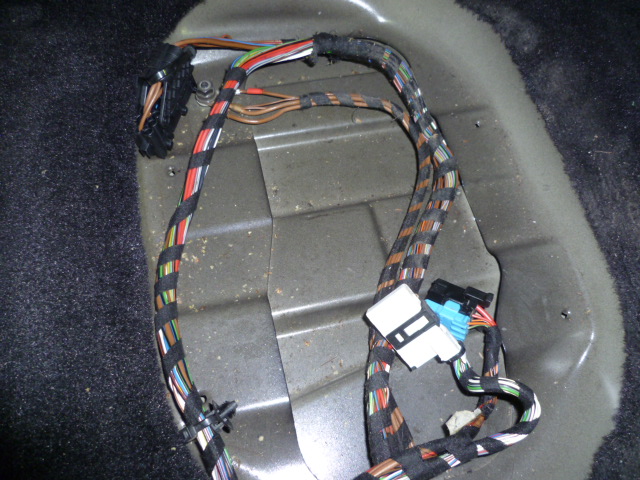

BTW. Does your car have carpeting under the seats? I have a '99 and there is NO carpeting under the seats - its just metal. I think they changed this in later years.

There is carpeting under part of the front seats but not all. If I slide the seat forward all the way it exposes some metal. I would think yours is the same way right?

if I recall correctly, mine looks something like this (pic not from my car). Seems like there is definitely room for improvement.

Same on 2001 coupe. I think Porsche did this deliberately so that you'd hear more of the exhaust sound inside the car. If you want to make it quieter, I would think adding some sound insulation there would help.

It's been awhile but iirc there are some drains down there. This wasn't done for exhaust noise and you DO NOT wanna cover up that area.

I put Dynamat in there - didn't see any holes and there was nothing hiding anything.
