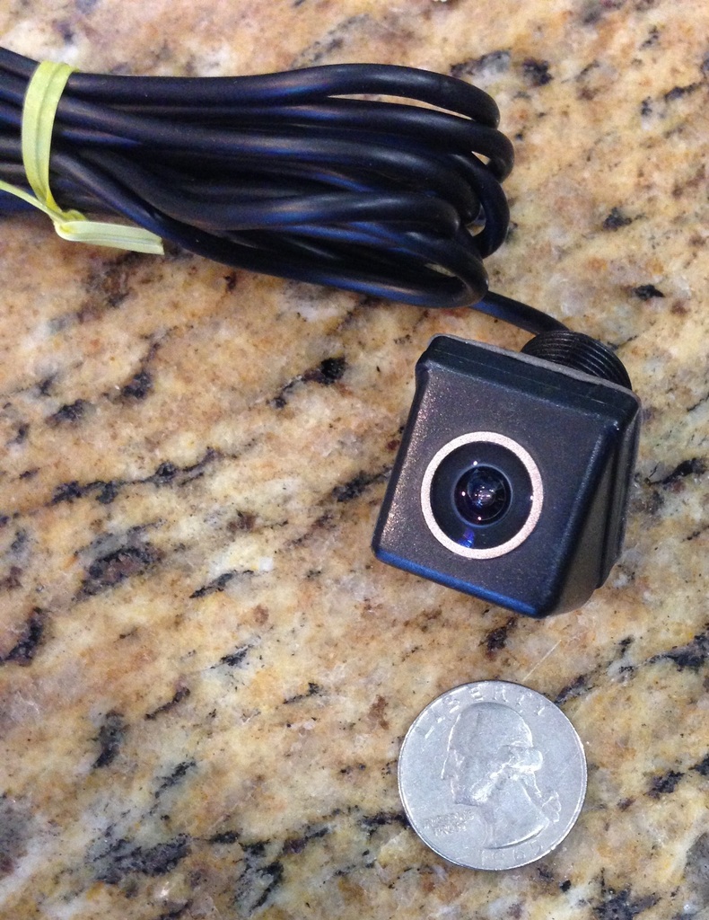

Here is the camera they are installing. It will be flush mounted, between the license plate lights near the license plate. Once installed it should be pretty much out of site.

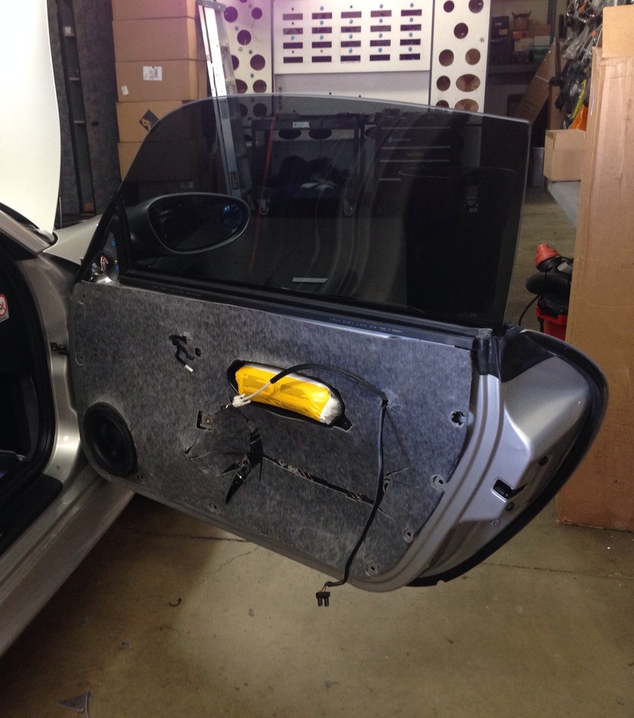

So far we've added Dynamat to the outer door shell on the inside and on the inside of the shell. Probably overkill. We then added one layer of Sound Barrier before the door card went on.
There is no question that it has helped. The stereo was difficult to hear at highway speeds but no more. Vibration is down a lot as well. Unfortunately there was not enough room to add the sound absorbing barrier. So we added dampener and sound barrier.

1. Doors - Dynamat and Sound barrier
