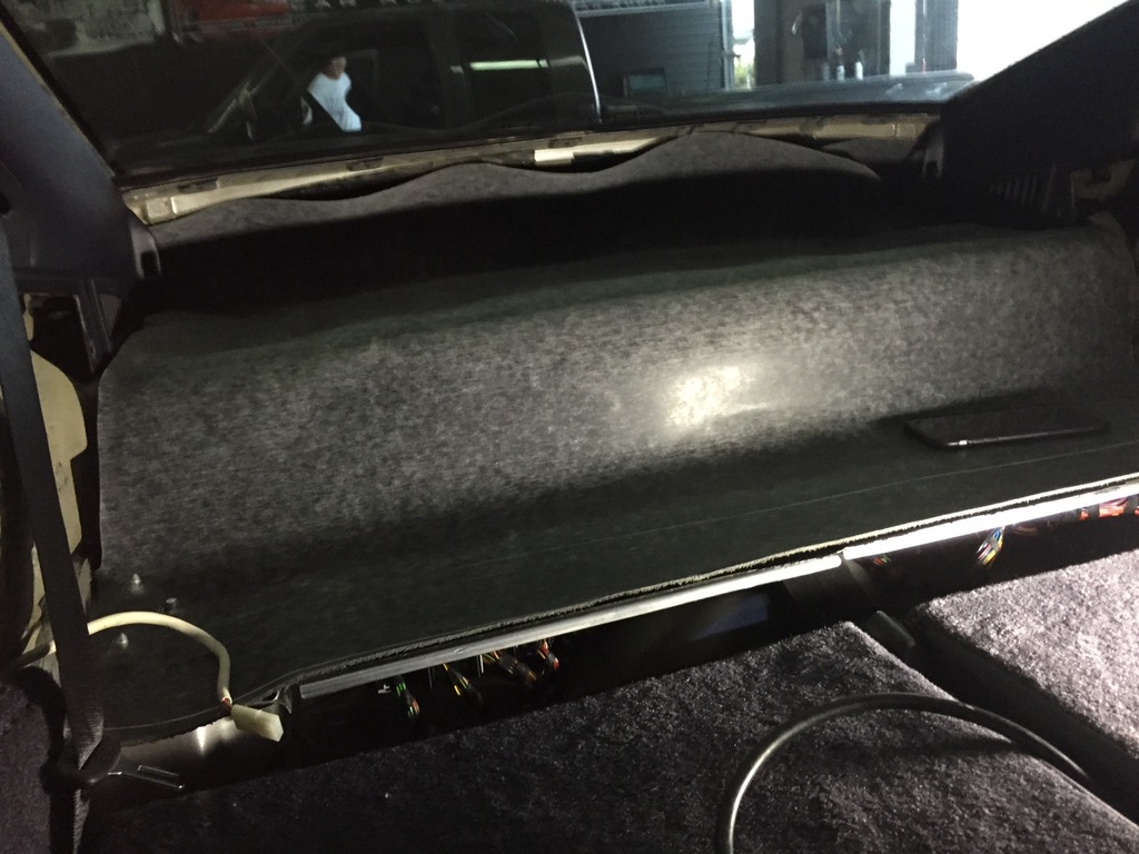

Last post to wrap this up.
The problem I was faced with was excessive noise in the cabin as mentioned original post. To resolve it I did the following:
1. Adjusted the driver window to seal tight against the weatherstrip. Had to loosen the glass and raise it in the clamps. This got rid of highway whistling and wind noise

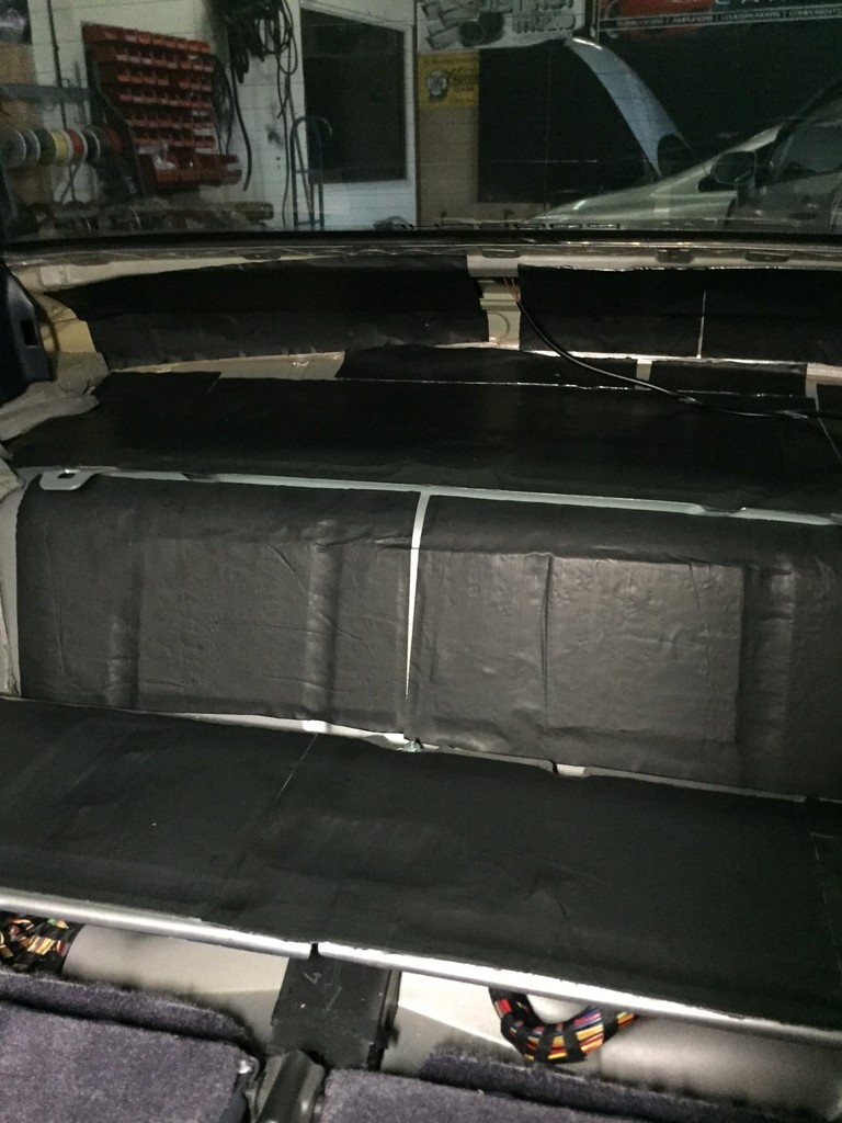

2. Dampener and Sound Barrier in the Rear Hatch area behind the back seat and above the engine
After Damplifier:
After Sound Barrier:

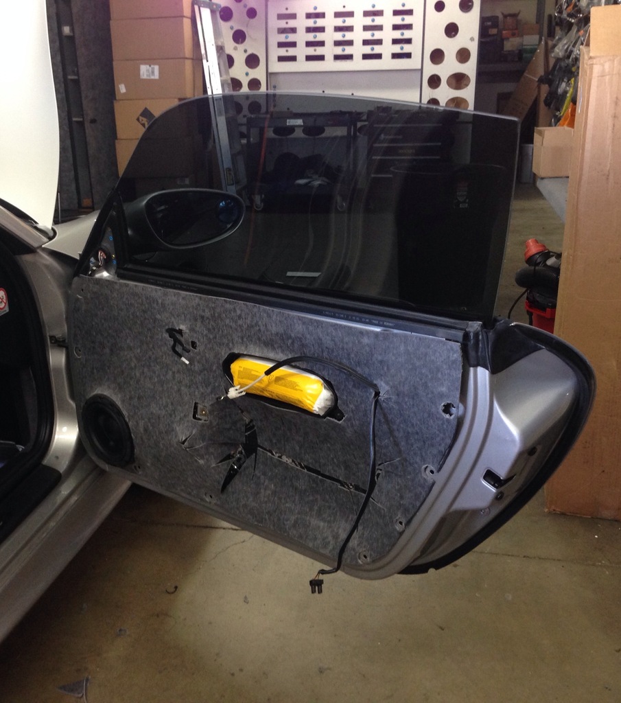

3. Dampener and Sound Barrier on the doors (Dampener not pictured as it is covered by the Sound Barrier)

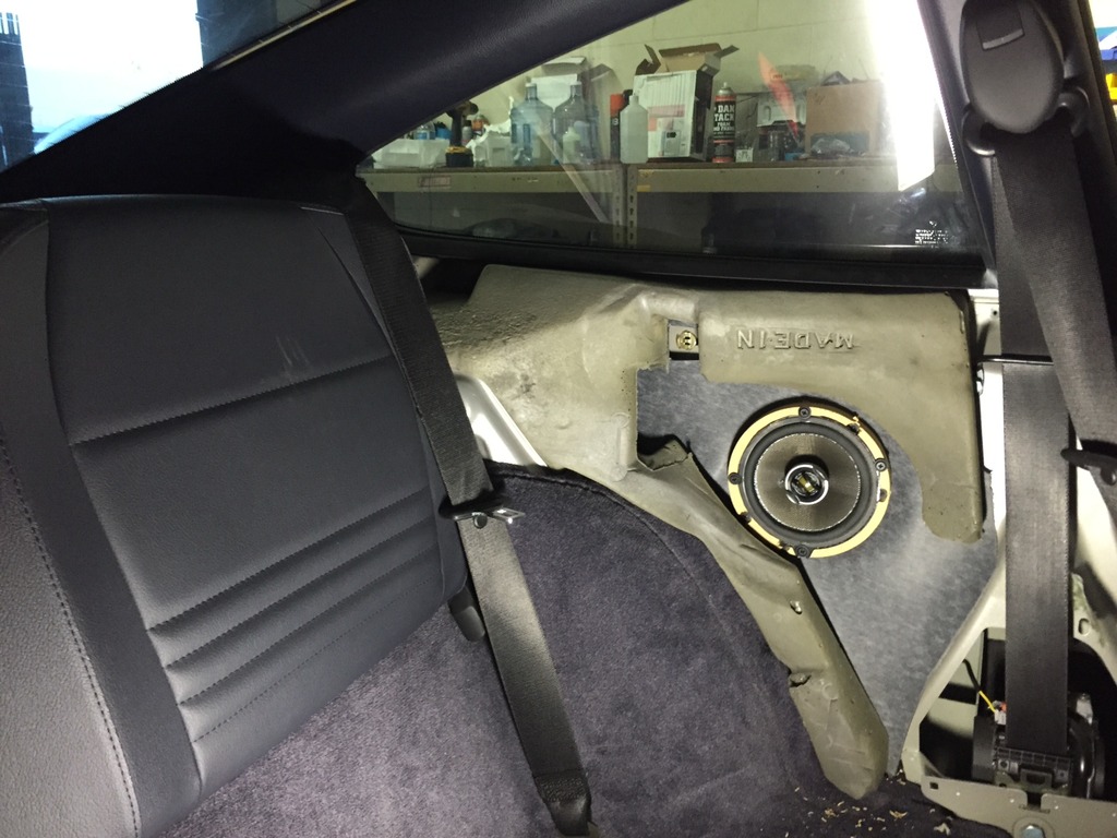

4. Dampener and Sound Barrier behind the rear quarter interior panels and on the wheel wells (not pictured but behind this)
This has made a significant difference in reduction of vibration, rattle and interior noise. The car is quiet now and you can easily make phone calls at highway speed. The door speakers and rear speakers sound better as well.

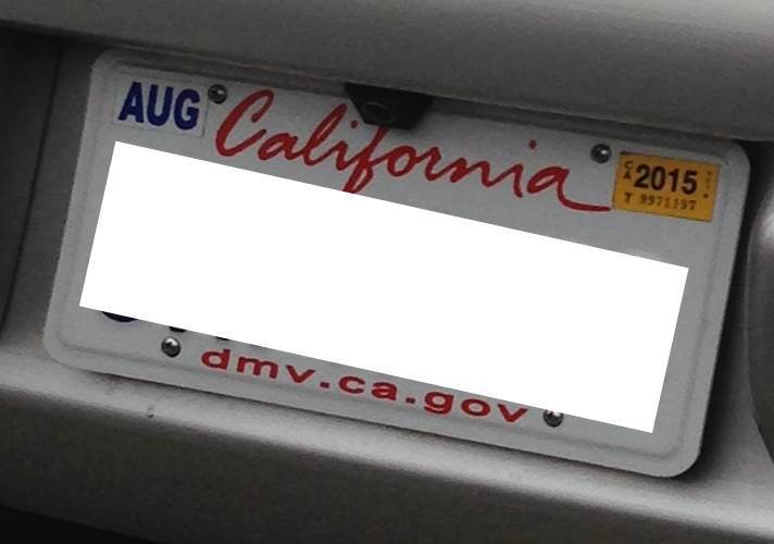

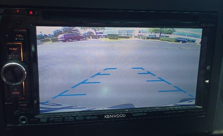

While they had the car apart I had a rearview camera installed in the rear bumper. If you look at the camera display below, the closest blue marker is pretty much an inch beyond the bumperettes. So you can back up to a wall with full confidence and stop 2" short. The camera angle is so wide that you can see the license plate itself. Also the resolution in this display picture is no where near as crisp as it looks in person. The image is very clear.
Camera:
