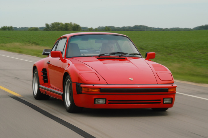

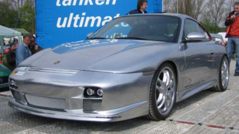

Originally Posted by Fierofly
After looking at it without the fenders, I'm thinking someone needs to design a slant nose mod for the 996.
Heres an attempt that looks bad, but I think done properly with proper hood vents it could look good
Old Jun 9, 2015 | 03:14 AM
  #48
Porsche_Shiftin04's Avatar
Joined: May 2015
Posts: 244
From: Lebanon, CT
Porsche_Shiftin04 is infamous around these partsPorsche_Shiftin04 is infamous around these parts
Lol yeah that attempt looks bad lol. The slant nose would look awesome on the car though. Too bad Porsche wouldn't make one as a special anniversary. That red one reminds me of am SC model I almost bought for 1,000.00 dollars once. I will forever kick myself in the *** for not buying it. The needed a lot of work but it did run. An indy mechanic in my area that I talked to about it said those motors can cause lots of head aches. I passed on the car and still wish I didn't.
