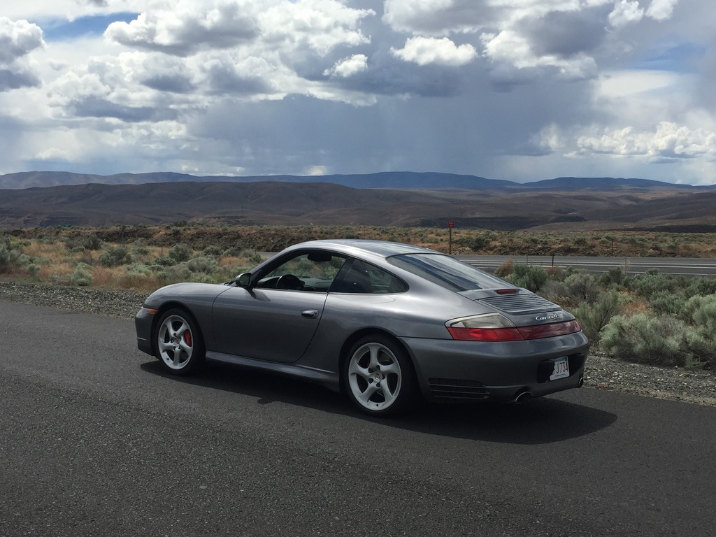

As far as every time I look out in my driveway or go for a spirited drive/ road trip, I smile! Life is to short to drive boring cars!
