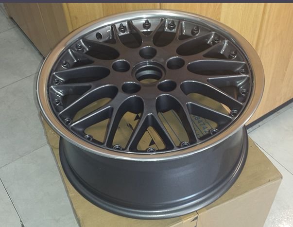

Old Sep 10, 2015 | 08:16 AM
dingo32's Avatar
Joined: Apr 2010
Posts: 12
From: Malta
dingo32 is infamous around these parts
i was referring to the split rim bolts (the titanium ones)
i took a picture of them .
