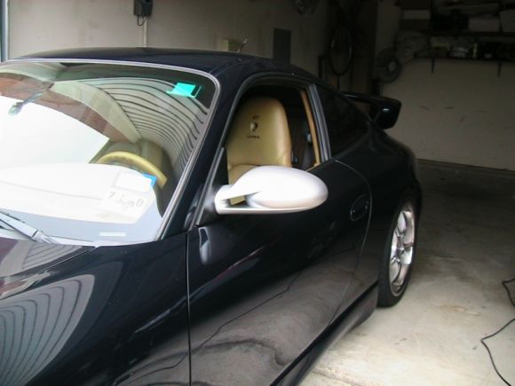

Today I decided it was the day I would start on my 996 to 997 mirror conversion from Extreme Motorcars. I figured like my front end conversion I would take detailed pics and notes. To start, this kit is awesome. Exact replicas of the 997 mirror that will fit to the 996 chasis. The mirrors are good hard plastic that won't break. As always Jeff at Extreme was awesome! Shipping came very quick and he even sent an email that explains the install.
Now, to get into the install!! The mirrors do not come with the glass, motor or brackets. But, no worries, all your 996 parts will fit right on these mirrors. That's what makes these mirrors so awesome!! You can have the 997 mirrors at half the price as other conversions that come with it all together. In the package will also be a tool that extreme made to ease the process of getting off the spring on the inside of the mirrors.
To start you will need to take the cover off on the inside of the car. You will see 3 screws (one is behind a little round foam piece) and the wire harness. The wire harness pulls right off and then remover all 3 screws. The mirrors will now come off the car.
Take mirror and turn it over. On the bottom of the mirror there is a little plastic piece with a water drain hole in it. Pull that plastic cover off. You then will be able to see the inside of the mirror assembly. If you push on the back side of the mirror lense it will pop out. Remove the two brown wires. Once that mirror itself is removed you will see the motor being held in by 3 Philips head screws. Take those off and the motor will come out. You will see on the backside of the motor a wire harness containing 3 wires. They are black, red and white.
I went halfway down the wire and cut it. You will need to add wire due to the 997 mirrors being longer. You can buy a wire harness from Extreme now that makes it plug and play. It wasn't finished in development when I bought my mirrors. So, I will be adding the wire.
On the back side of the mirror is the wire harness male end and 2 screws that hold it in. There is also two other little screws that hold the bracket to the frame. Remove all these screws. Go back to the front side of the mirror and remove the 3 screws holding the bracket to the mirror cover. Now you will be able to slide the mirror cover off.
All that will be left at this point is the bracket and the plastic housing cover. I managed to get the housing cover off but I honestly wouldn't suggest it as part of a step. The right way to do it is to pop up the bottom of the plastic cover and then remove the two rubber garments. This will allow the plastic cover to move freely. You will have to move it out of the way to get to the spring.
This step is the only hard part. The spring is tensioned and held on with a C clamp. This is where the tool that came with the kit comes in to play. You will see in my pictures the correct way to install the tool. Make sure the mirrors are in yhe folded position before starting the process. You want to tighten the tool all the way down as far as possible. The opened in the tool will allow you to get out the C clamp. The C clamp is tough to get out, you will need a couple flat head screwdrivers and a small pry bar (pry bar us not a must. Just helps). It will take some time and patience but it will come undone.
Now you're ready to start the opposite process with the 997 mirrors.
Start by putting the spring tensioner back on. Make sure to do this process with the mirrors folded as well. Then install the wire harness with extension wires and the mirror motor. Then install the mirror lens and they are ready to bolt back up to the car.
This is a fun Saturday project. I am not finished with my install, due to being sick I decided it was time for me to stop once I had both 996 mirrors removed and fully disassembled. I need to put together and install the 997 mirrors. I hope I am feeling better tomorrow and can do so. I will take more pictures when I finish the rest of this project up. Here is some detailed pics. If you have any questions please feel free to comment or inbox me.

I decided even though I am sick I wanted to get one mirror at least mounted. The picture quality sucks cause it's dark out. I will get good sunlight pics once I am completed.

Is there a difference in width between the 997 mirrors and the conversion mirrors, it looks like the factory are a little wider, is that due to a possible different glass mirror shape?

Ny, the mirrors for the conversion are the same width as stock 997 mirrors. The 997 mirrors are wider than the stock 996 mirrors. That's why the motor wires need to be extended.
