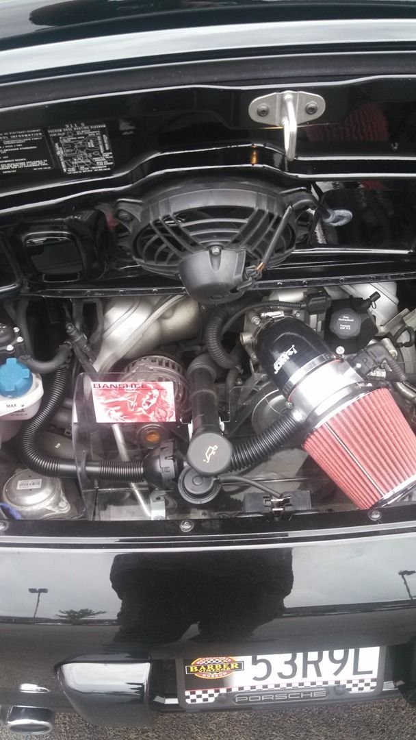

Porschetech3 - what is your custom cold air intake?
Thank You

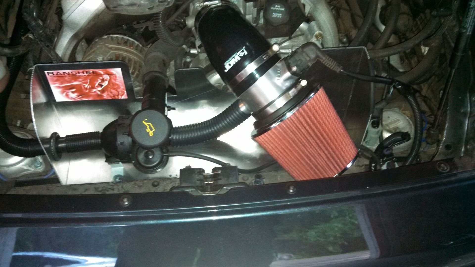

Custom cold air intake with sound symposer retrofit including K&N filter and aluminum heat shield
Custom cold air intake with sound symposer retrofit including K&N filter with Lexan heat shield
You can see the sound symposer in the tube off the left side of aluminum MAF housing directly under oil fill pipe

cWade thankx...The sound symposer has a remote control to turn it on and off. With it off it sounds just like all other cold air intakes (witch is a very good sound). but with the sound symposer ON it has another level.
