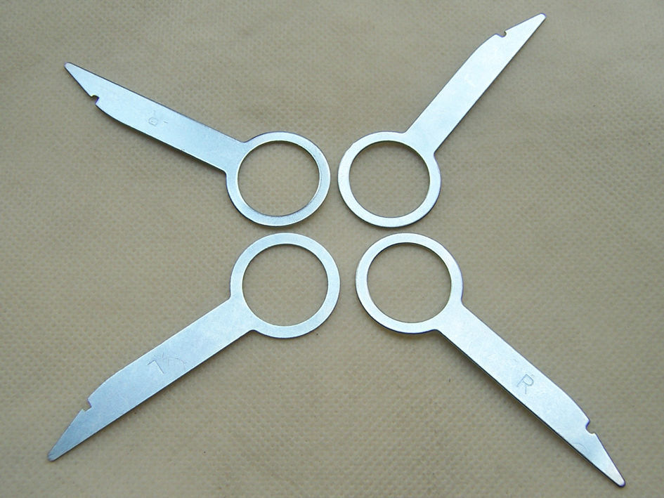

would the correct keys look like this?
and you need just 2 not 4 ?
thanks

It may depend on the brand of your head unit. I bought these for a Kenwood for $2 and they worked great. They took about 2 weeks to arrive.
http://www.ebay.com/itm/2pcs-Kenwood...3D262293770970
I would go to ebay and search for double din keys for whatever brand you have have.
Will post a before and after on the head unit wiring and install in case it is helpful.

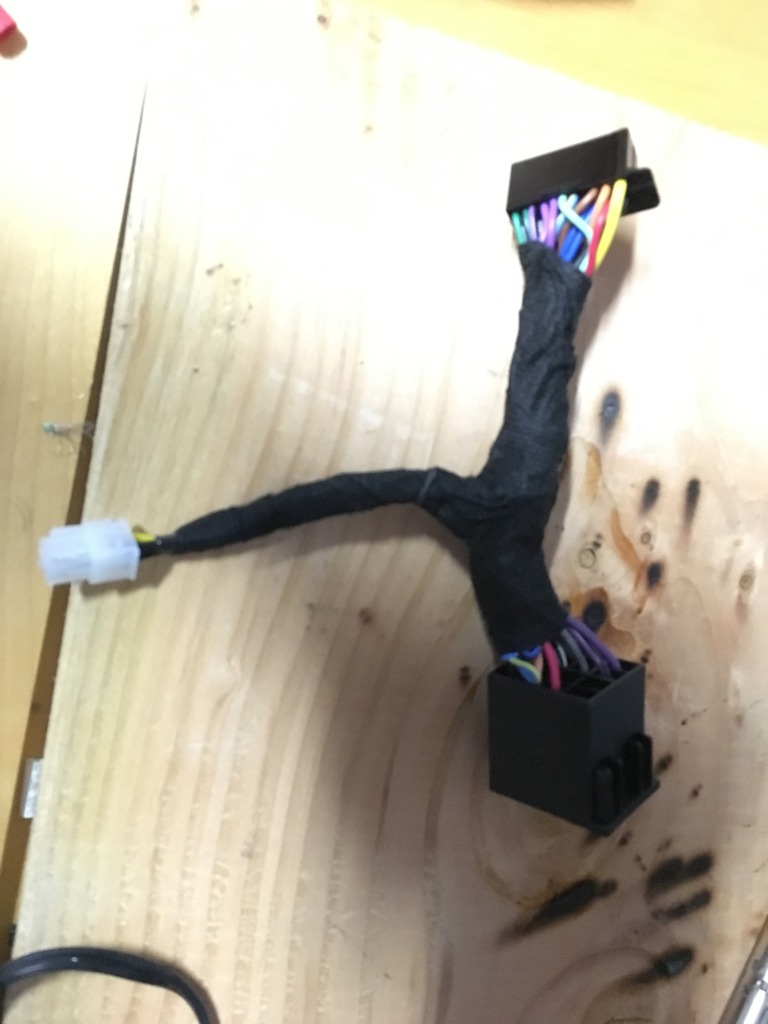

Rewired the head unit. Over the years all the tap splice add ons built up . The head unit had trouble sliding in and frankly it looked like a high school install.
So I shortened all the wires, solder connected all, shrink wrapped each connection and felt tape wrapped everything. Also added a t-connector to power the front and rear cameras and to turn on the amp. The entire set-up plugs in with connectors except for the RCAs, Antennas and Mic.

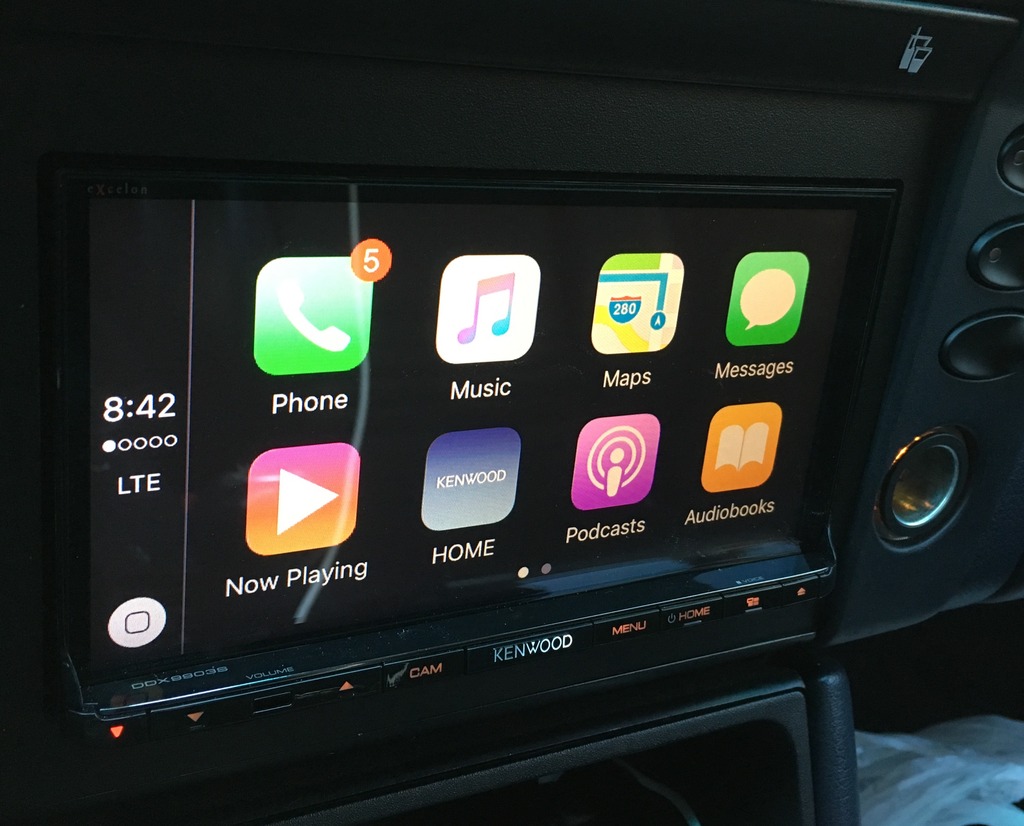

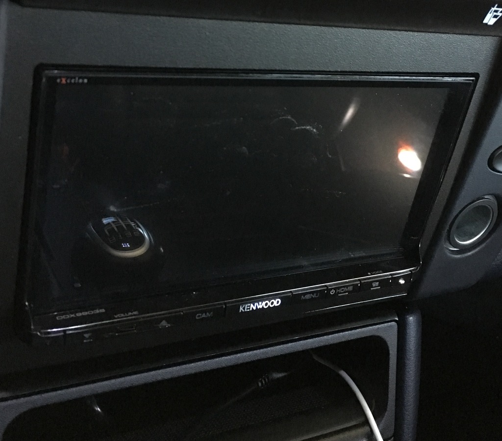

Install done. Kenwood DDX9903s with capacitive touchscreen and Apple CarPlay.
