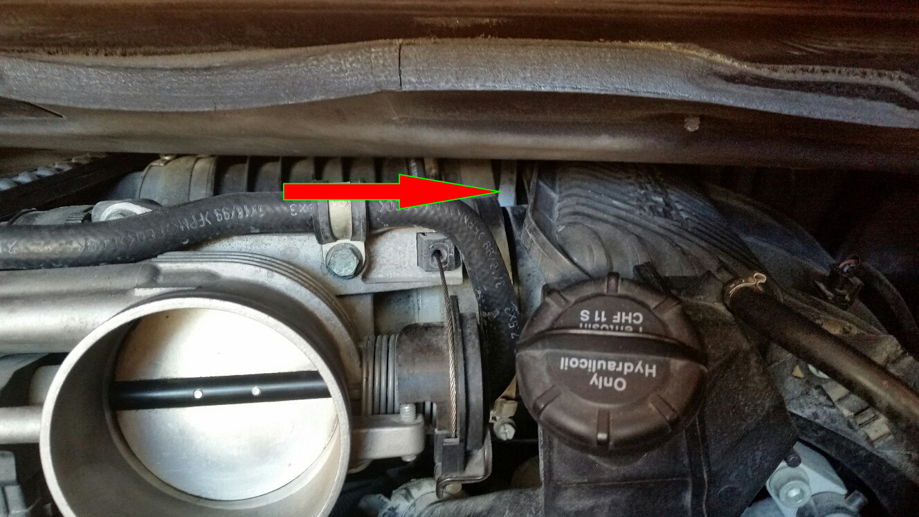

Ok... worked on the car a bit more today. I think I pin-pointed the issue. The intake plenum (I guess its called)
on the passenger side of the engine. The POPPING sound is defiantly coming from this area (see arrow in photo).
I believe when it made the BIG "Ba-boom!" sound, that might have blew my intake plenum loose. Looks like the
clamp was knocked askew (see photo). I'd like to gain access to the top of the engine area right above that plenum...
to see if the plastic (black plastic) cracked when it made the loud "ba-BOOM!" noise. My car is a cabriolet... but it
doesn't look like I can gain access via the rear deck area where the convertible top rests in the down position.
Does anyone know if there is a trick to gain access to the top portion of the engine???

A friend of a friend (who's a mechanic, but not for Porsches) stopped by took a look at the car for about 20 min. He's going to stop by tomorrow to look a bit more at my car but told me to get a PCV valve for it... as that might be part of the problem. Cant find a PCV valve as a part I can purchase for the 996 engine (1999). He also suggested to pick up a Fuel Pressure Regulator as they might have been my actual issue from the start.
I can buy a Fuel Pressure Regulator for around $120. Since I can't seem to find a PCV valve listed as an item I can purchase for the 996... does anybody
know what Porsche may call a "PCV valve"?

I was thinking this is (photos I posted) a hose that connects to the plenum... two clamps on each side of the (1 inch) hose. Originally Posted by wildbilly32
AOS: Air Oil Separator
Looks like the explosion, blew the clamp and hose out of their "normal" place. Now an air-leak's causing my problem with running (LOTS of "popping"). And inability to actually run smooth and steady. Sounds HORRIBLE.

Sorry to say but it sounds terminal. For these cars to backfire and blow off some intake hose/clamp generally means the cam timing is way off. Originally Posted by MrOz
I was thinking this is (photos I posted) a hose that connects to the plenum... two clamps on each side of the (1 inch) hose. Looks like the explosion, blew the clamp and hose out of their "normal" place. Now an air-leak's causing my problem with running (LOTS of "popping"). And inability to actually run smooth and steady. Sounds HORRIBLE.
Try to find someone with a durametric and see if your cam deviations are way off the charts.
If you continue running it, you'll get more collateral damage. I can only speculate at this point that your chain guides and or tensior(s) could have failed. They could also have collateral damage from the IMS tensioner paddles. Once again, these are only guesses at this point.
You could borescope each cylinder and see if you have any piston to valve contact. That way at least, you know if the damage is limited to only the top end.
I would also drop the sump and inspect for any debris and inspect the oil.
Good luck and don't run it any more.
Figured it out today. The loud sound had blown the two large intake hoses (with their clamps) slightly off from where they should
be. BOTH hoses on the passenger (right) side of the engine had blown off enough for a serious air leak. Took me an hour of not fun work to get those hoses and their clamps back on. What a P.I.T.A. But... SUCCESS!!! Soon as I saw how bad they had blown off I knew that I'd found the problem. After the final tightening of the hose clamps, and turning that ignition key, the car started like a CHAMP! Now runs smooth as you'd possibly want it to run. ZERO issue. Unbelievable. And... almost imperceptible to the human eye, to see what actually had happened. If it weren't for that ONE hose clamp (that my friend spotted) slight askew, I would'nt have had any idea of what the cars issue could have possibly been.
SO... what did we all learn? If you hear a huge POP! then some smoke from your engine bay after changing your fuel pump. And the car runs like sh*t, then go directly to your intake plenum area and look at those 4-5 inch diameter hoses with the hose clamps. They WILL be the source of your problem. Hook-em back up and you'll be back on the road.

You probably have some underlying issues you may not be aware of. Intake hoses just don't pop off for no reason and the "BA-boom " sound you describe could signal something more drastic.
It may be running ok now but would be interesting to see how long it lasts.
