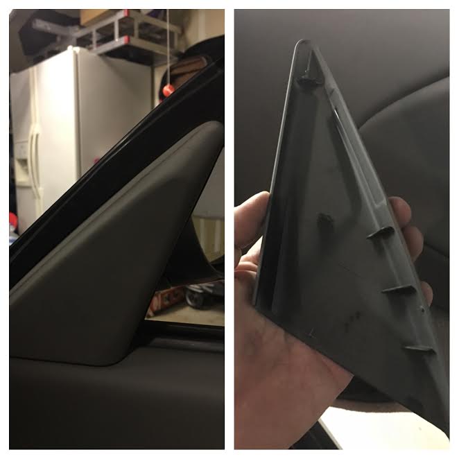

Ugh!! What is this piece called? Thanks
Upon removing I broke the clips that are part of this part. Belongs to the passenger side on my 2003 C4S. Do I have to replace the entire piece? What is it called? Thanks..

How about some more clues - inside, outside, where on the car?? You can see parts diagrams at auto atlanta.com - maybe you can find it there.

clips in the corner towards the front of the window on the passenger side. Drivers side has the control for the angle of mirrors. Ill check out that website. Thanks..

Maybe in this diagram - not absolutely clear.
http://www.autoatlanta.com/porsche-p...section=807-10

Here is one on Ebay, you have to be carful and slide them into place or the top plastic clip will break.
http://www.ebay.com/itm/Porsche-996-...xUPf86&vxp=mtr

there should also be a part number on the inside starting with a 996 and is called the interior side view mirror triangle.

Good question. But you can fix it with some epoxy and a couple of trim panel anchors. The ones that hold the trunk liner to the front bulkhead might be a little too big, but the right type. Faster than driving to a boneyard/dealership.

Mirror attachment point finisher.

People typically brake this bc it's ment to removed in their fashion:
Pop out the bottom then slide upward to remove. Not just pull bottom and top. That's how that tab gets broke.
