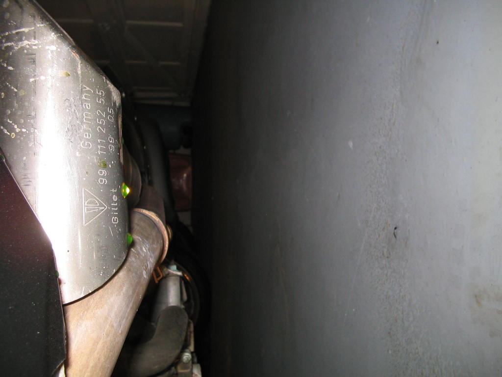

Hi,
I just bought my first porsche (99' 996), and I noticed I'm getting some fluid leaking off the driver's side exhaust tip after driving. The fluid appears light brown on the floor, but appears greenish when dripping off the exhaust tip. It seems to be too watery to be oil.
Is this where the coolant overflow drainage occurs? After driving hard, there can be a sizable puddle on the floor.
Thanks and hello everyone,
Steve

I would think no leak is 'Normal'.

Thanks for the link...I'm hearing that coolant reservoir leakage problems are common on 99' 996's. Hopefully I won't have any problems with my "Repair Master" entended warranty covering it.

Mine was replaced 'out-of warranty' earlier this year (99-model as well). They told me that they see a few in for this occasionally.
It happened the day after an oil-change, the check engine light came on, then it started spraying (no really...spraying) fluid out of the engine compartment. I had to have it towed in on a flatbed....
After it was all said and done the repair was definately not cheap. I would have them look it over ASAP...
Good Luck
-TS

I almost guarantee is is your plastic coolant tank. Mine cracked twice for no apparent reason. Should be a cheap fix.

A replacement coolant tank cost me $650 for parts and labor.
