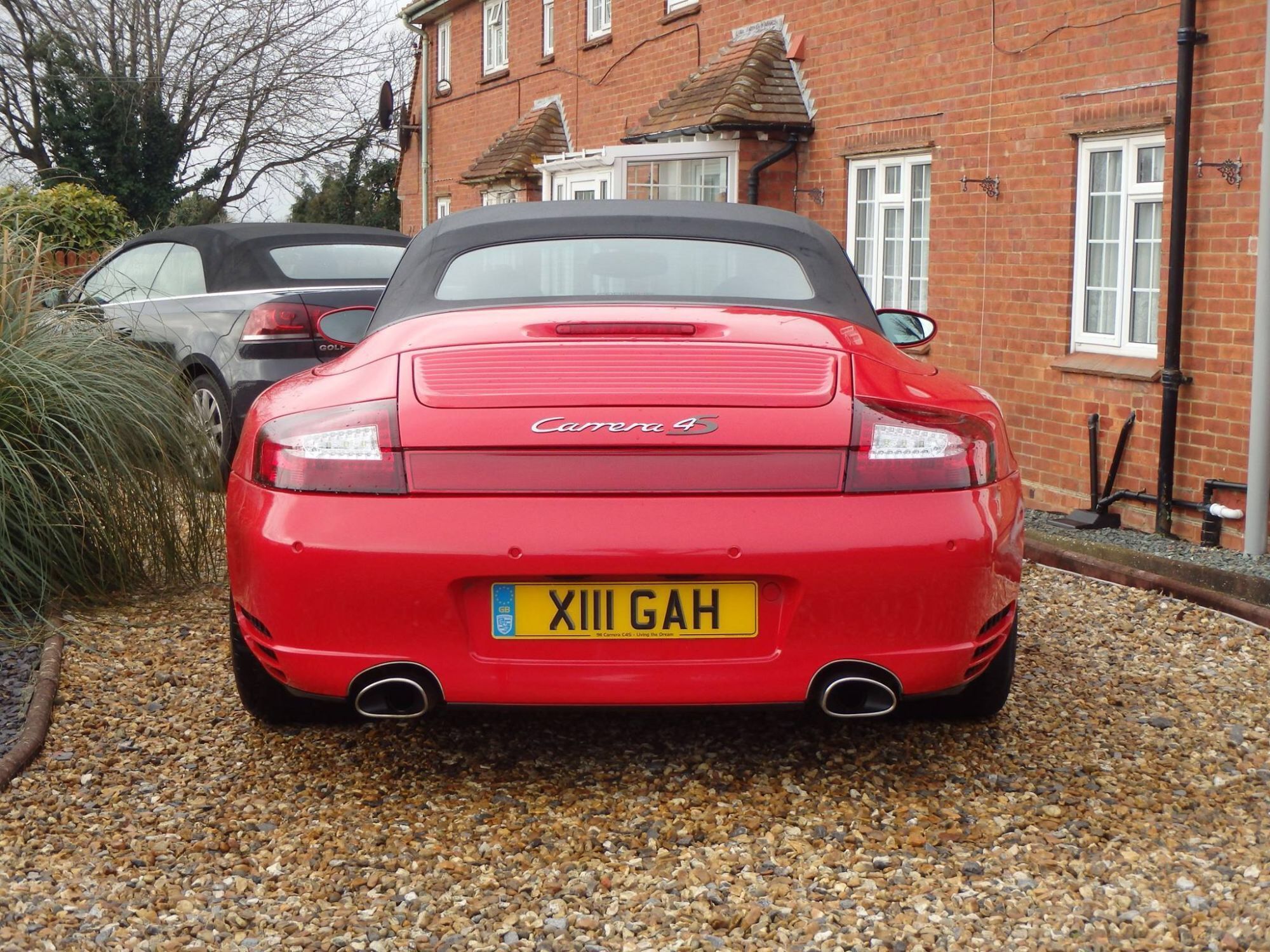

your car looks bad A$$ as is. Why ruin the look with this LEDs & it ruins the line with the deck lid reflector. IMO
but if you have a red car then it may work cause the red all blends in.

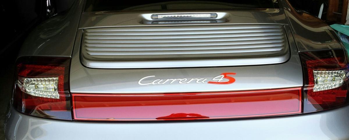

I recently purchased a C4s and came to the same conclusion. Instead, I just switched out all exterior bulbs with LEDs, replaced the oem relay with an led flasher relay and boom, updated lights. Keeps the pen look but the bulbs themselves look more modern.

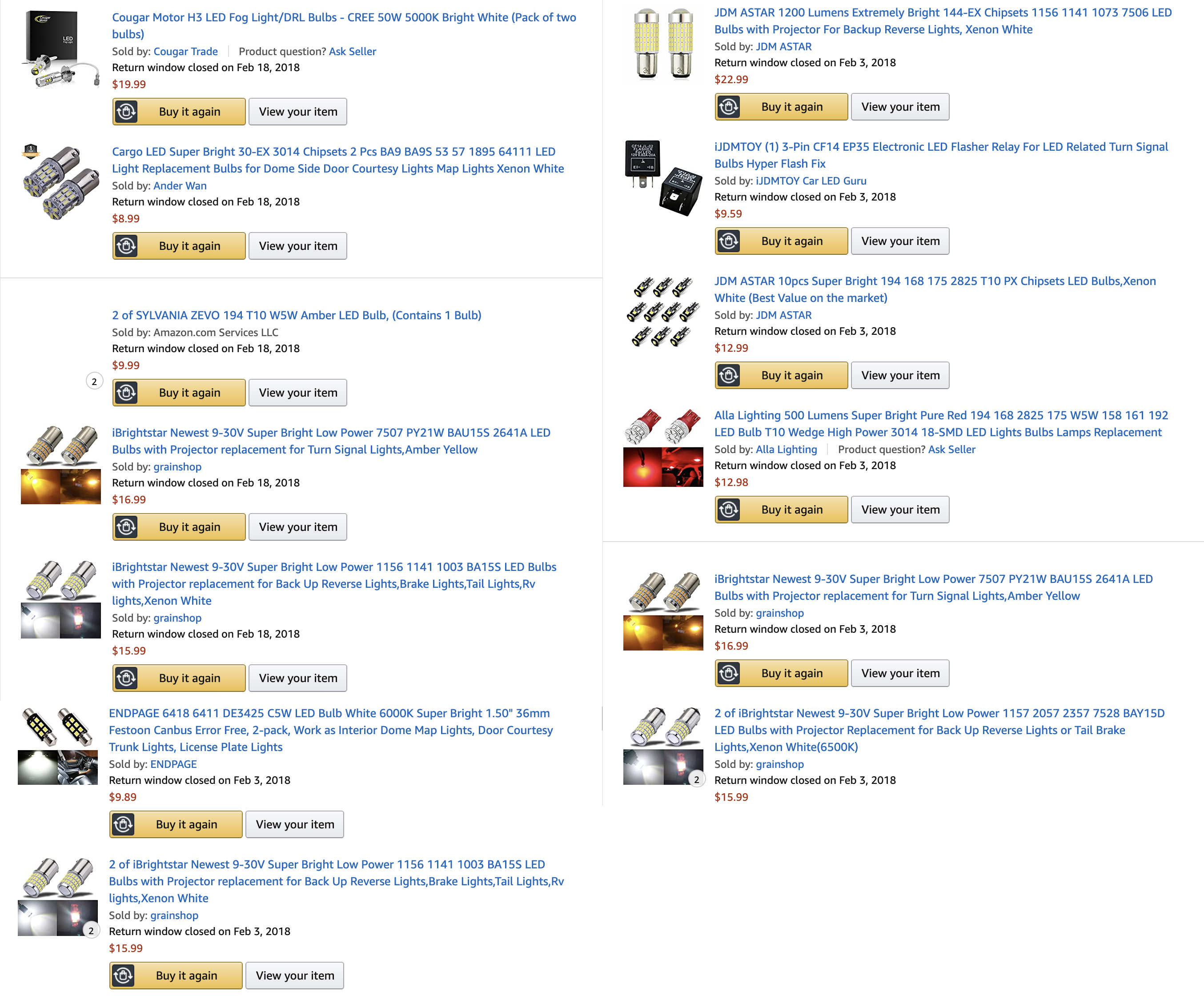

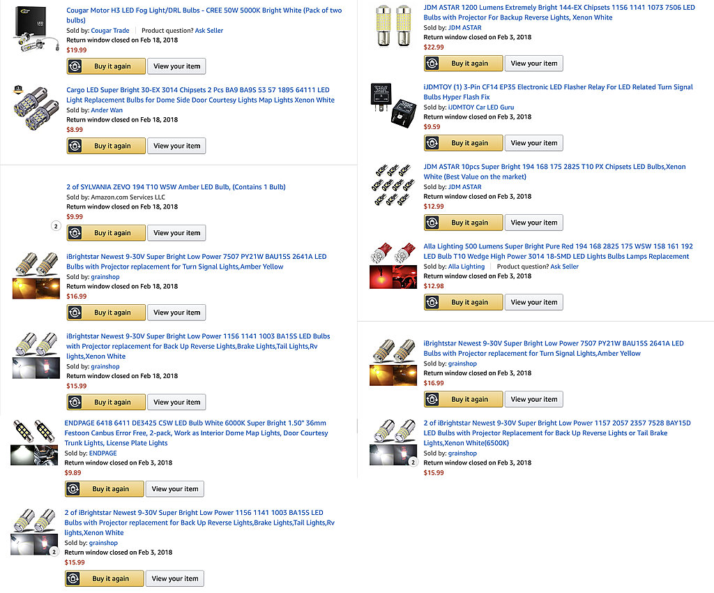

Can you list parts and where you got them? willing to try it plus body color match the white part of the lamp lens and trying to light up the red strip for a killer look..

Sure thing, check this out, also posted below. Not as useful as posting links, but given it's been a while since I purchased (all from Amazon), some products may be not currently/no longer available. I think it's a complete list, but I also think I ended up with a couple extra, lol.
BTW, all bulbs are now a couple years old and still working perfectly with no bulb warnings on the dash or blown bulbs... hope that helps.
