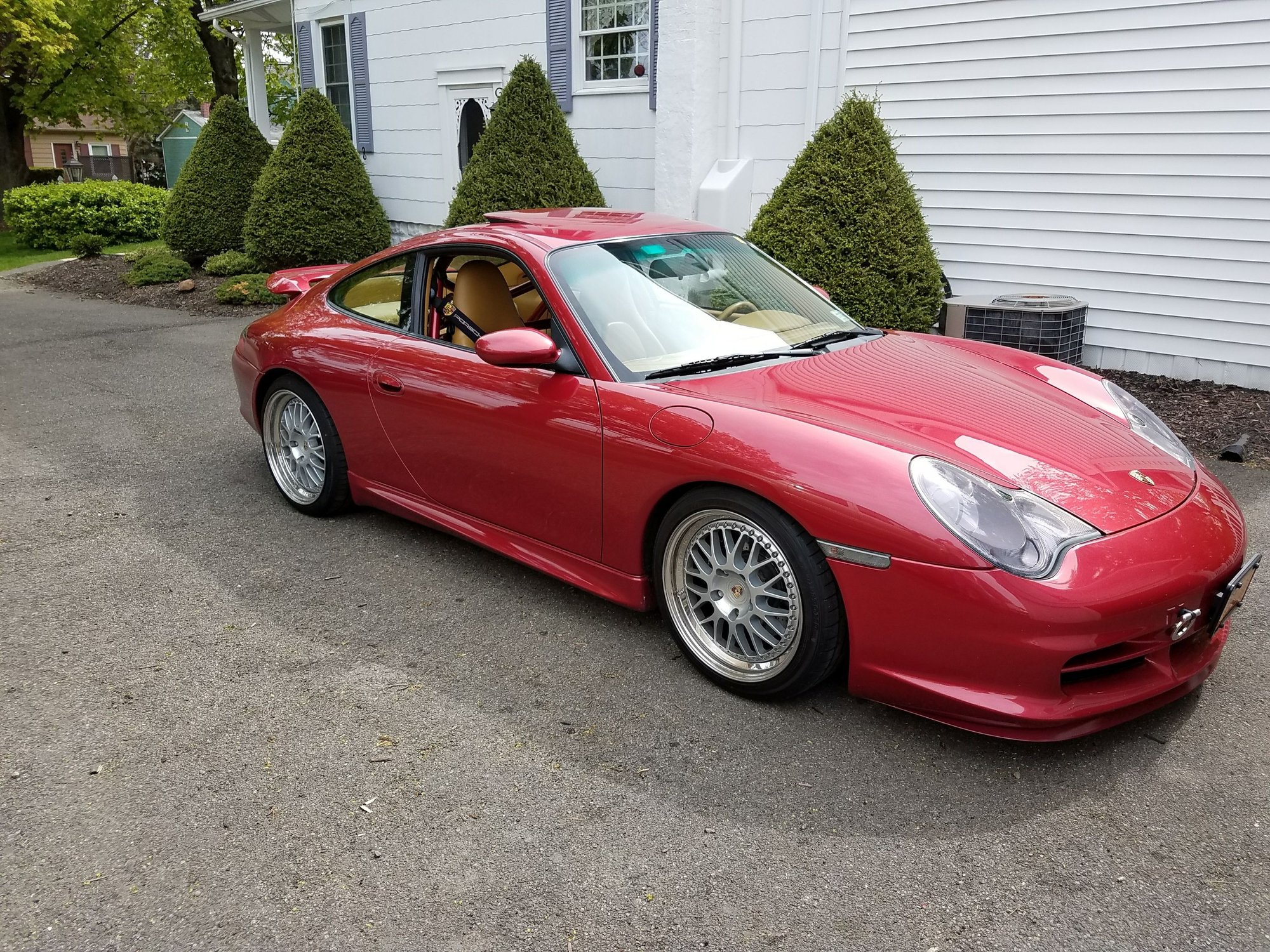

Thanks for the reply, I was going to buy the B6's which were the wrong ones. Your car is very nice by the way. I really like the rear spoiler, is it from the Aero II kit or aftermarket?
Thank you
It is a Carrera Aero II
The B8, is made for the lowered 1" springs, if you don't get the right shock, it will not work properly with regards to the area of piston travel.
