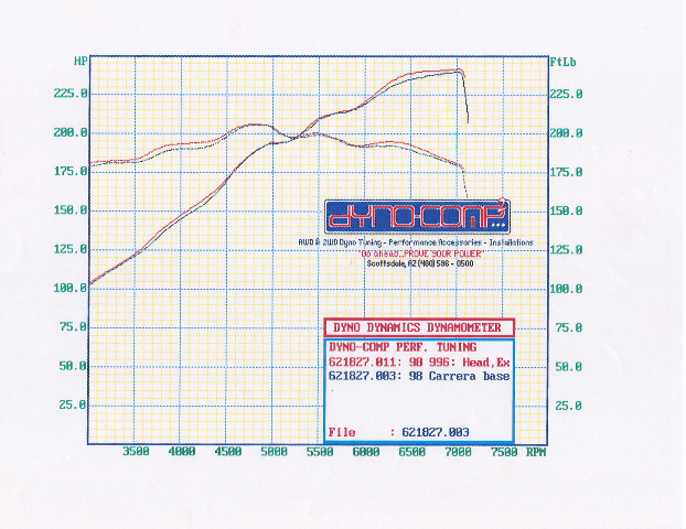

I was told that the after dyno shows 8whp increase mid-rpm and 3whp up top. I'll scan the before and after charts once I get them and post them here.

The most interesting observation from the charts are that with adding the headers and muflers alone (no tuning, intake, ...) the fuel got really fat. The before fuel map shows a prety stable line at 13:1 and after the mods the line became 12:1. Obviously a bit rich for a NA car. I need to decide if I am going to go intake or not and highflow cat or not so I can get the tuning done.
My butt dyno can't detect any additional power but then I was without the car for 4 days and riding my Ducati 996 Superbike around so any car feels like a slow pig. The sound though it much better. I still can bearly hear any exhaust note with partial pedal. Mash it to the floor though and it all comes alive.

Finally got around to scanning those dyno charts.
The charts have the car listed as a '98 but it is a '99.
Baseline was run on a Friday and final was run the following Tuesday. (5/16/06)
Also there was NO time given to the ECU to adjust for the changes so I'll have to get a new run done before and after I get some tuning done.
Mods are Ztek headers & mufflers, & Green filter.
Note how rich the thing got after the install.... tuning needed badly?
