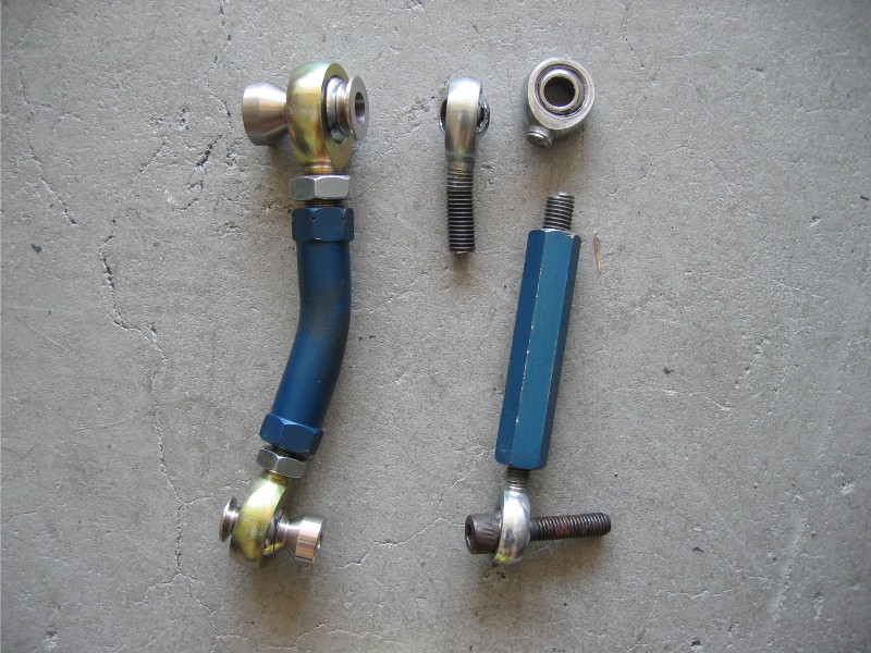

the TRG links are NOT overkill. you made a WISE choice my agency power heim joints kept binding a breaking... total of 6 times!!!! i ended up getting the TRG links and what a huge difference. i get very smooth operation, full range of motion and more importantly, no binding. the TRG links have high misalignment spacers which allow full range of motion, and have HUGE heim joints. check out my previous THREAD
