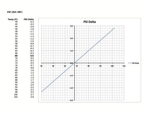

Air Temperature affects tire pressure. See graph I found on one of the posts here or on another forum.
Also interesting read:
http://www.tirerack.com/tires/tirete....jsp?techid=73
